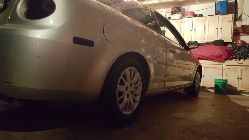

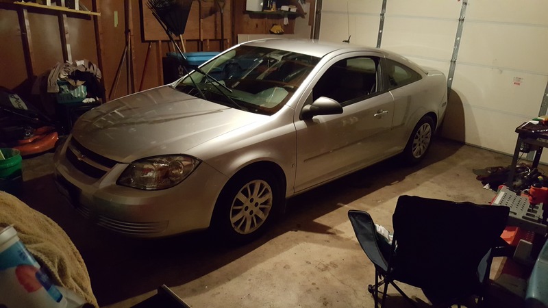

Heres how she sits thus far...
Ill take some better pics outside. Ran out to snap a few because threads are worthless without pics
