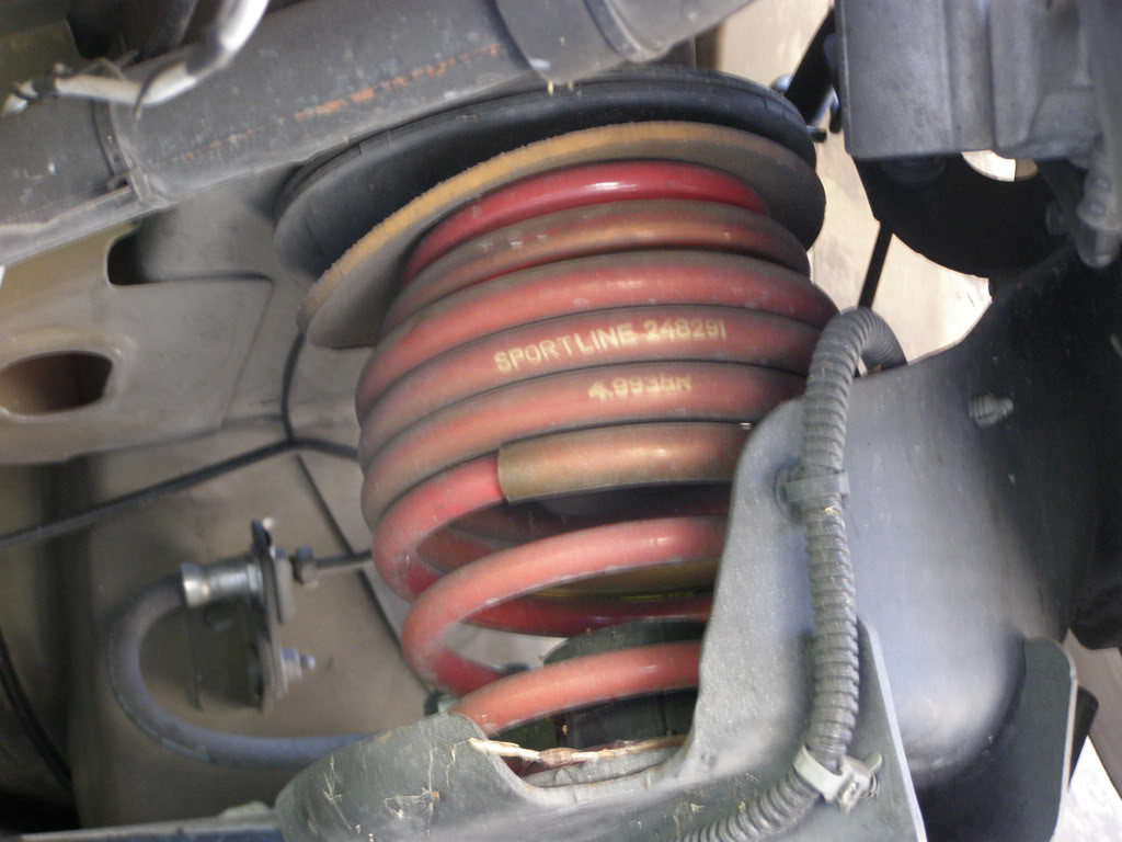

Even still, looking at the rear suspension on sportlines always makes me laugh. Barely any room for the suspension to travel at all.

I'm sure it's not a very comfortable ride.

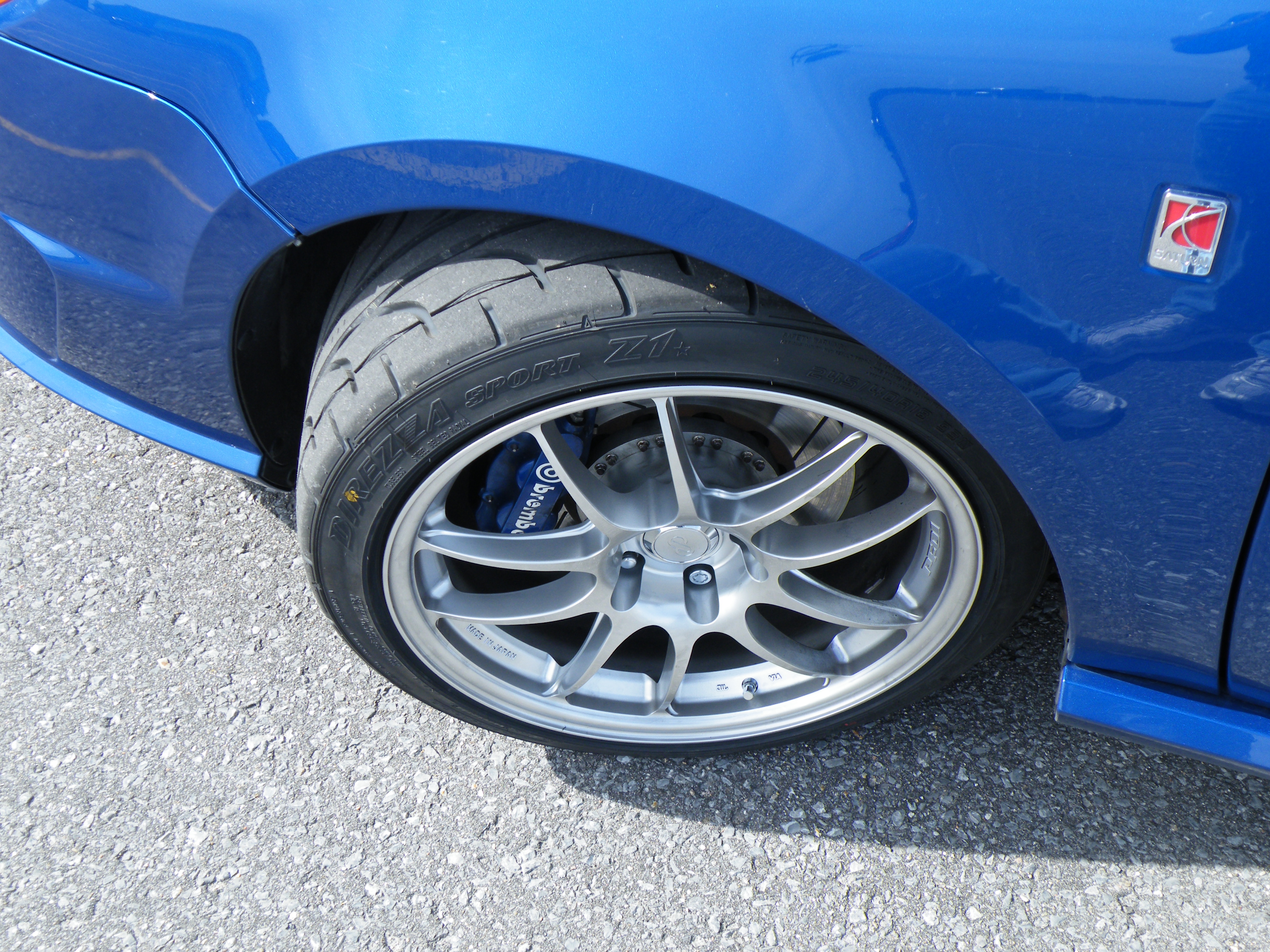

Continental Extreme Contact DW 235/40/18. Wish they had more forward bite. I only made 18 autocross laps on them, the only 18 I have ever made, so realize that I'm as novice as novice can get, but I never ran out of side bite with them. They easily out handled the driver. Once I gain experience that may not continue to be true, but that'll be a long time coming. They are really inexpensive too.

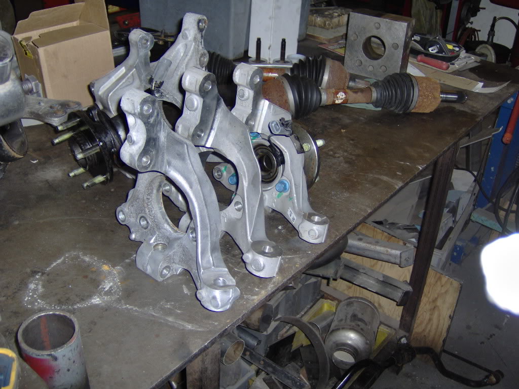

we looked at the hiper strut it was supposed to go on the TC GM cancelled it for cost.
its not worth the effort. the gains are not there...
all you need is to get your abs back, but that takes a machined pontiac grand am wheel bearing. The good news is, you can put the bearing on as is, and bore out your rotors. Oh then the stock wheels dont fit the bore is too small. So machine the hub center down on the bearing. Oh ya, and they are both 5 x 114.3 and 5 x 110 . BUT bonus! With 5 x 114.3, so you could go to 9.5 wide wheels like me.
you know you want to.

Hey John if you don't mind me asking what is the cost like to change to LNF knuckles assuming we take the grand am hub route I like the idea of the 9.5 inch tires lol
If you would rather pm or email me lol
Last edited by Hobbitjones; Feb 13, 2013 at 01:03 AM. Reason: Automerged Doublepost
Old Feb 13, 2013 | 08:38 AM
  #48
Powell Race Parts's Avatar
Joined: 04-25-11
Posts: 6,128
Likes: 47
From: Port Perry
Buy the knuckle and the axles.
buy a grand am wheel bearing. front. If going to 5 x 114.3 just machine the center hub to the 65 mm or so , as the LSJ/LNF bearings have. It will be thin. You will need to space the wheel bearing out to maintain rotor/caliper alignment. You may need to machine the bearing attachment holes in the knuckle I dont have my notes handy.
Re drill a stock rear hub to 5.x 114.3; install.
install new wheels and carry on.
machining? 100-300 dollars. Depends how busy and how good the machinist is... things to look out for? hurting the abs sensor wires while machining, making the wrong size holes for stud installation etc....
parts? whatever they cost, new or used.
I gotta few knuckles here 65.00 each. new LNF. So does Mongorat.
LNF axles are a lot of money. I dont use LNF axles, I use a different ,small diameter axle shaft, costs 2000 for 6 shafts to be made from a very strong material used in race axle shafts for Corvette. Uses stock inner tripod joint and a grand am outer CV jont. LNF werent invented when we did this for all the Cobalt race cars we built in 04/05.
