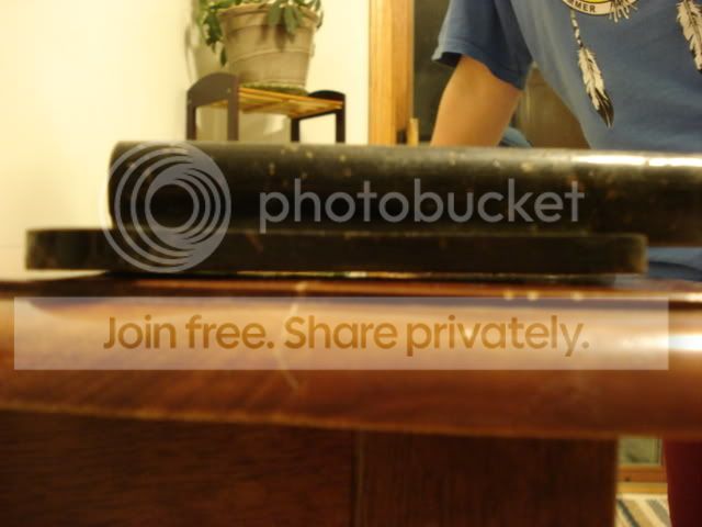

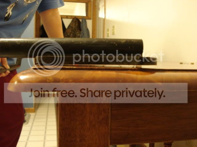

this is another brand's rear sway bar after being on the car for a bit, it is no longer a flat piece. if you honestly need explanation as to who's it is, pm me.

^^That's the bar I was originally going to get, but I'm glad I spent a little more and got the OTTP "Street" bar.
