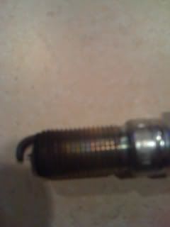

gapped the spark plugs to .032 and still having the third cyl misfire in high rpm but with stock tune nothing..? WTF GOD DAMNIT
i took pic of spark plug just to be sure ima post a pic and see if its messed up

Old May 14, 2009 | 01:33 AM

Sherm replace the plugs with new OE plugs gap them between .32-.35
Take off your Hahn intake, put the stock airbox back on. Drive it for a few days without beating on it, see if the ECM will relearn what it's doing.
