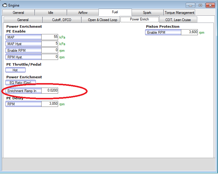

Old May 6, 2013 | 07:20 PM
Jesse's Avatar
Joined: 09-07-11
Posts: 3,254
Likes: 117
From: Las Cruces, NM
thanks, I think so too but I think he means one across the board and add fuel as needed. That is why I was asking.
I think you're modifying the Enrichment EQ Ratio. What SS1 is talking about is the enrichment ramp-in rate. This one:
