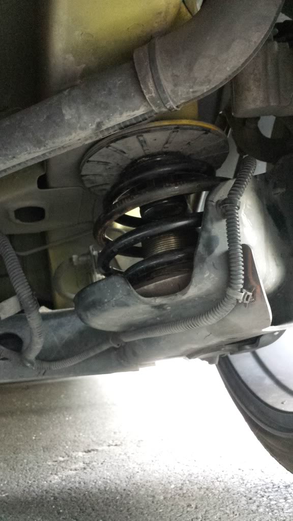

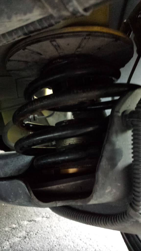

This is how it sits now. Ride is bouncy a little but when the rear hits a bump it hits hard.

now take that ring out

It's hitting hard because the bumpstop mount is hitting the coilover perch. take a hacksaw to that bumpstop mount and remove some material

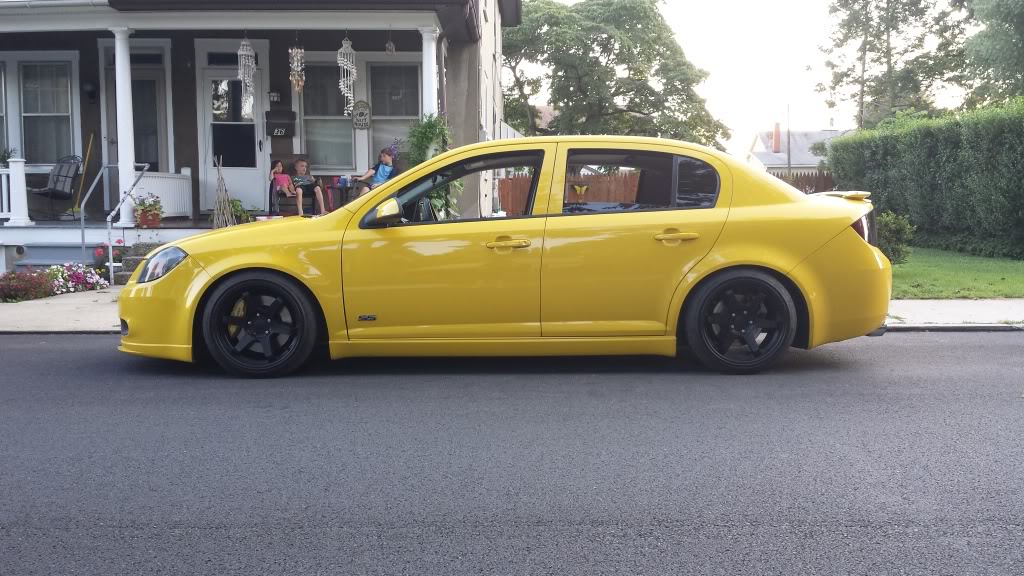

I'm not complaining about that life..? I was just giving an update.

Too much gap, lower it

This
