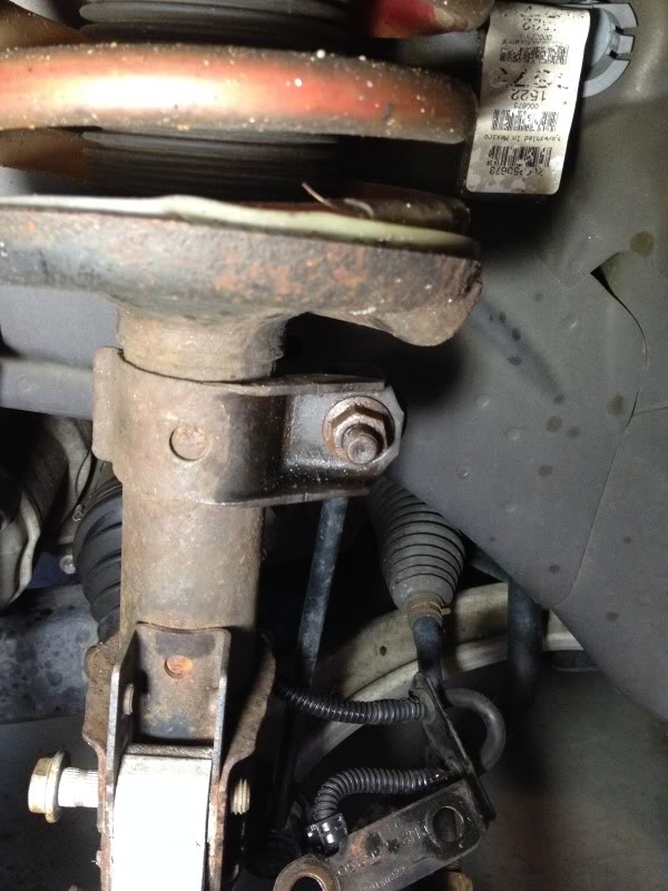

Hey guys. Need some quick help. Hoping one of you can. I'm putting in coilovers and can't get this damn bolt off. It just spins freely. How do I get it off??

vice grip the stud so it wont spin, but leave enough room to thread nut off, then use open ended wrench and hold the vice grips!

I believe u need an endlink removal tool. I think harbor freight sells it

my method works for free if you have those two tools lol
as long as you have new endlinks for your coils, or just be careful

Or wut slowbalt said. My nut rusted directly to the bolt so I am just replacing endlinks when I do coils

cant you just put a wrench on the other side?

not the stockers

im pretty sure the end link is a 15 - 17 mm on the inside of the end link. if its 15 you can use a pedal wrench for a bicycle.

Thinking about getting moog as well. Mine were a bit beat up so might as we'll replace them. I am going to end up cutting them as well. I couldn't get those f'ers off even with a tiny vice grip.
