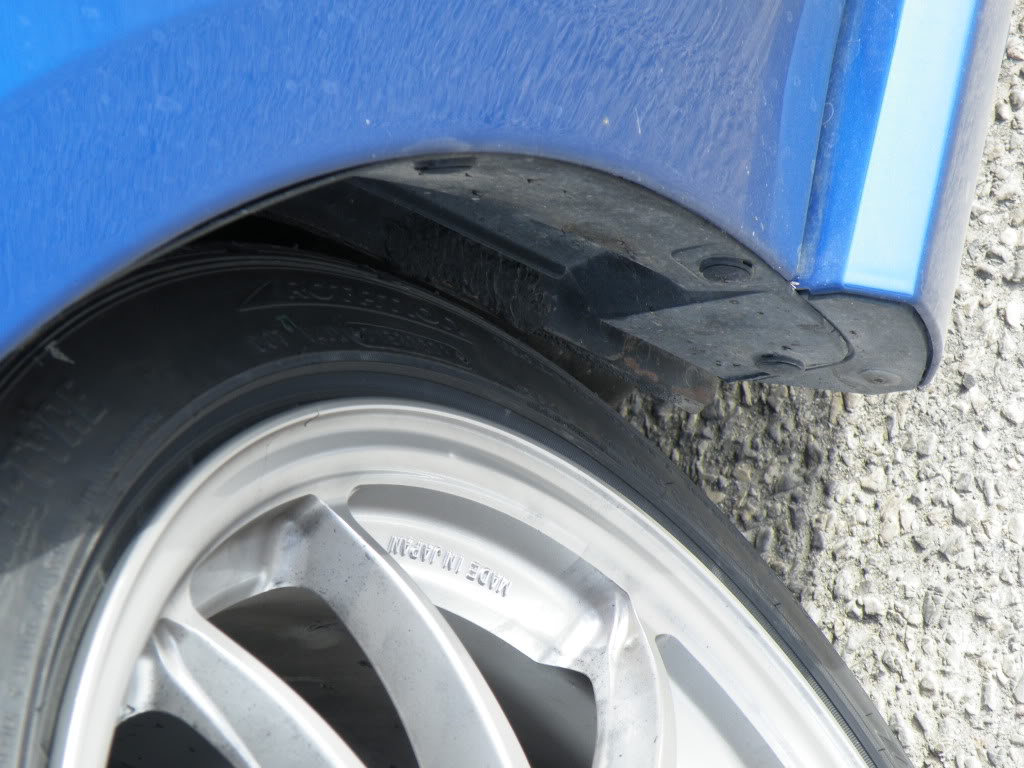

fits the HHR perfect with spacers! the YYZ will really perk up the HHR and make it a great combo for you, the rear springs can handle exceptional loads, and still a decent ride.
I figure with 5 mm spacers you are about 2mm closer than i am, you may have a little scuffing on the strut from the tire but I doubt it will be anything to worry about. The rear normally would run into the plastic inner fender liner, but with YYZ you will be good under load at the rear.
18 x 9.5 42mm offset

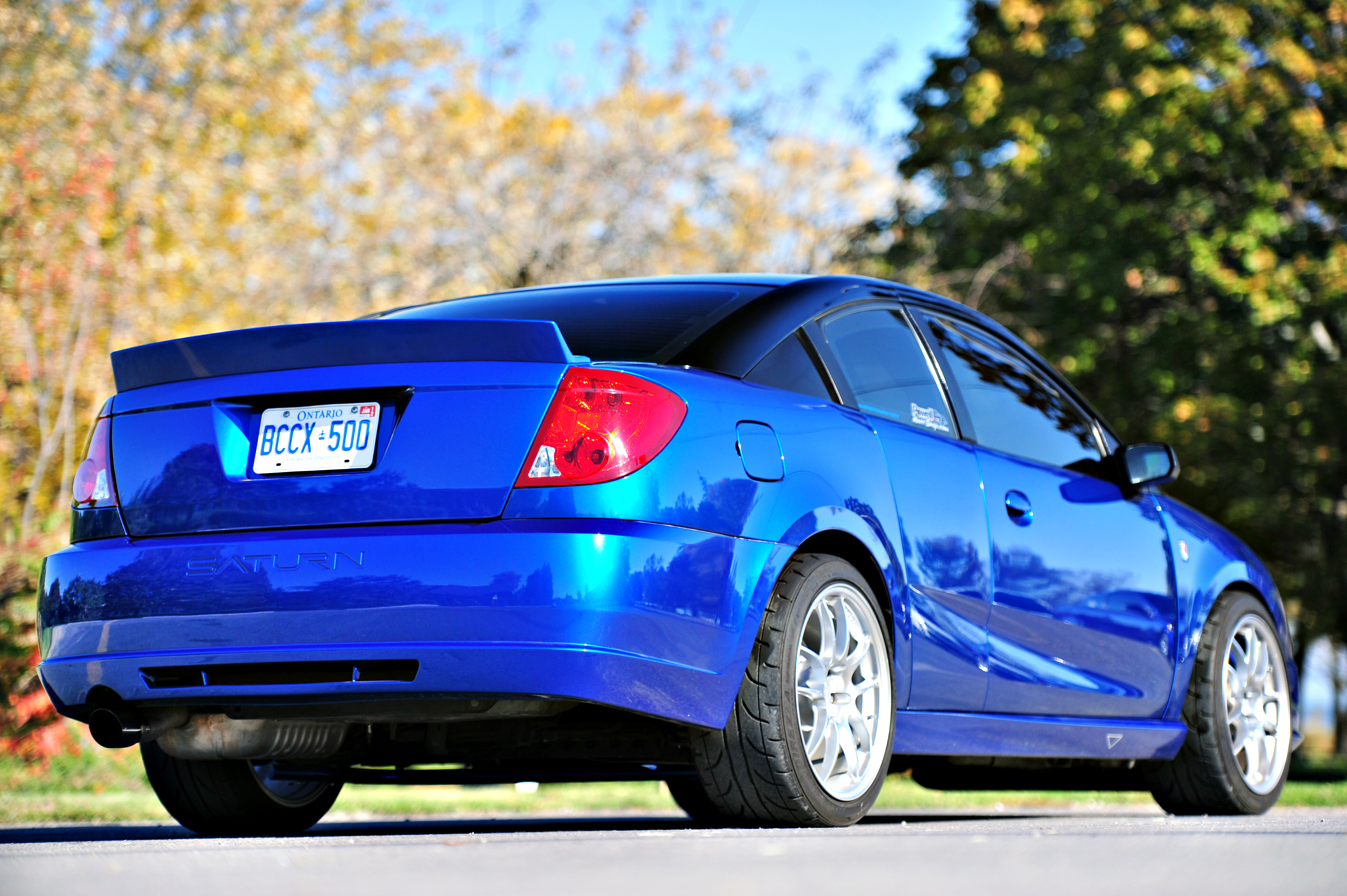

What size wheels and tires you running john?
Old Sep 26, 2012 | 11:45 PM
Powell Race Parts's Avatar
Joined: 04-25-11
Posts: 6,128
Likes: 47
From: Port Perry
same as the op. 245 40 18 on 9.5 enkei PF01/ I love the wheel tire combo, Dunlop Direzza star specs, like glue to the road.
