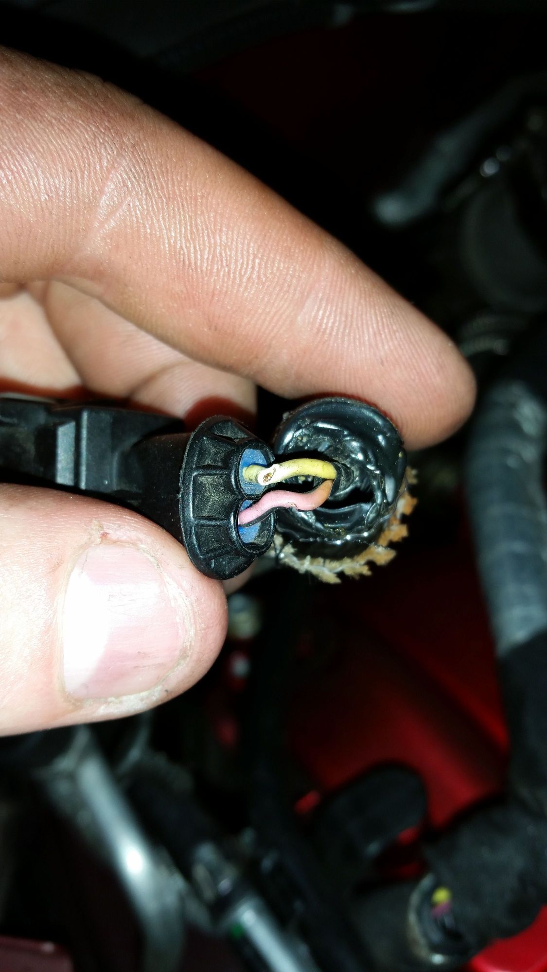

This is where the wire breaks. At first, you may not notice this break. I had to untwist the wires and slightly bend it before I found it was broke in half. The pink wire was nearly broken in half too. The insulation kept the wire in place such that it looked fine.
