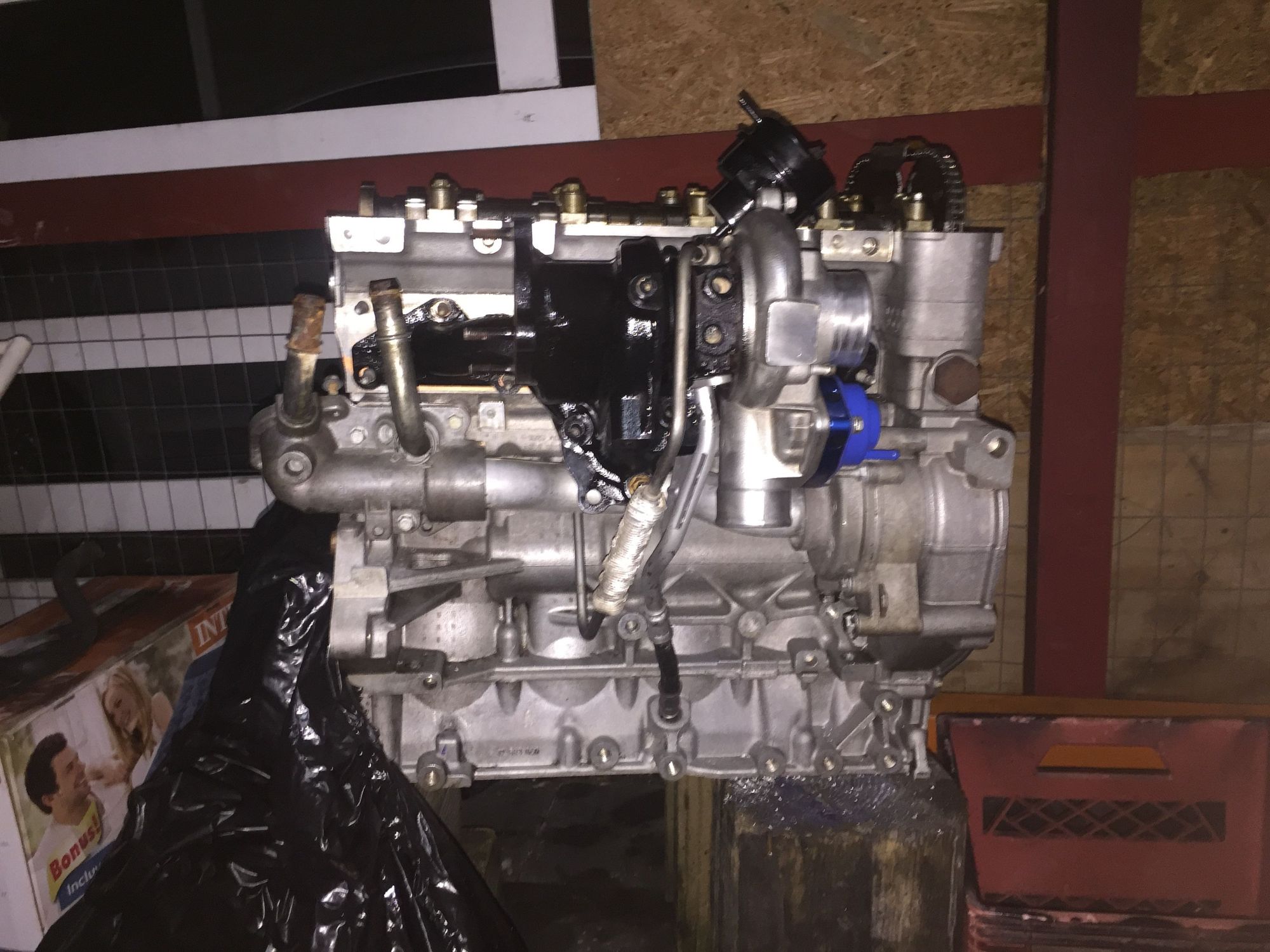

Cleaned the motor taped for the oil return wich fit perfect an so did the other lines the only line that had to be cut was the water line that returns to the thermostat housing i cut it at that side an atached a hose to it an use the same t pipe from the other side in the saab
