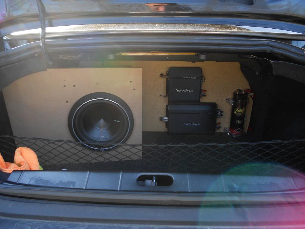

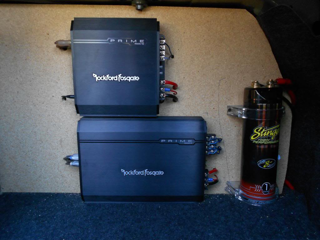

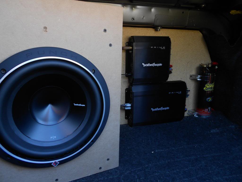

The box leaks so i'm going to pull it and re-seal it, wood glue would be a better option according to Emp. I tried liquid nails and hot glue along with screws. I'm going to pull it and re seal the box and then I should be good. Also, what gauge speaker wire should I run to the subwoofer? The amp is pushing 500rms and I have 8 awg power and grounds (JL audio wiring). The mid-range amp is amazing tho.
So what size wiring should be ran to the sub? I think i have really small wiring to it right now so I just bought some 14 gauge to re-run when I go to redo the box.

how bad is it leaking... you may want to try going with liquid nails if your going to pull it apart to reseal. liquid nails doesnt adhere as good as wood glue but it fillis in any "cracks" per-say a hell of alot better. so after regluing put a bead around all the inside seams and it should be good

its leaking enough to where if my head is inside the box i can feel the air flow. i can put my hand up and feel air coming out of different places along the seems. it doesn't seem reallly bad but i think it could sound better if i sealed it properly. I bought some Gorilla Wood glue i'll use and then I thought i'd go back on the inside and silicone along the seems.

ok if u bought wood glue just do 2 passes then the silicone
