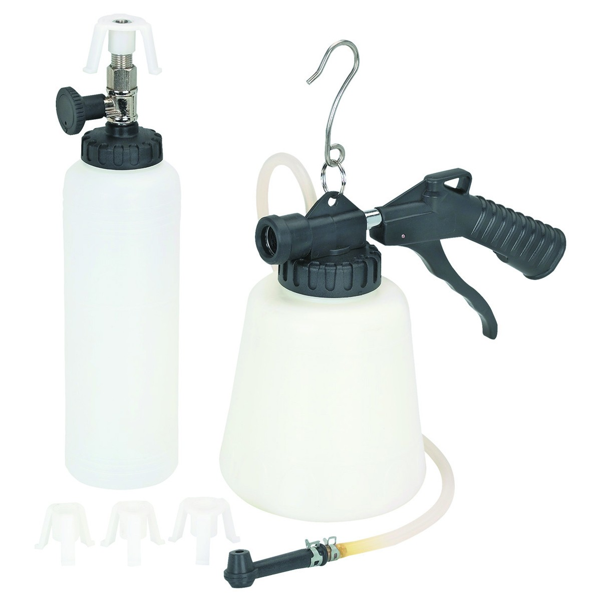

just to share the tool I use.
Brake Fluid Bleeder
how to use.
Note: I did not have the issue this guy in the video had with the refill bottle being blocked by the hood or over hanging frame of the car. also, I didnt use a seringe to remove the fluid from resovoir. I just removed the black rubber connector on the end of the hose for the bleeder valve part of the tool and vacuumed it out. He mentions you can do that in this video.
Old Sep 15, 2016 | 12:17 PM

I have a similar brake bleeder. It works great for flushing the brake fluid. It was my very first time doing it several years ago and it was a breeze
