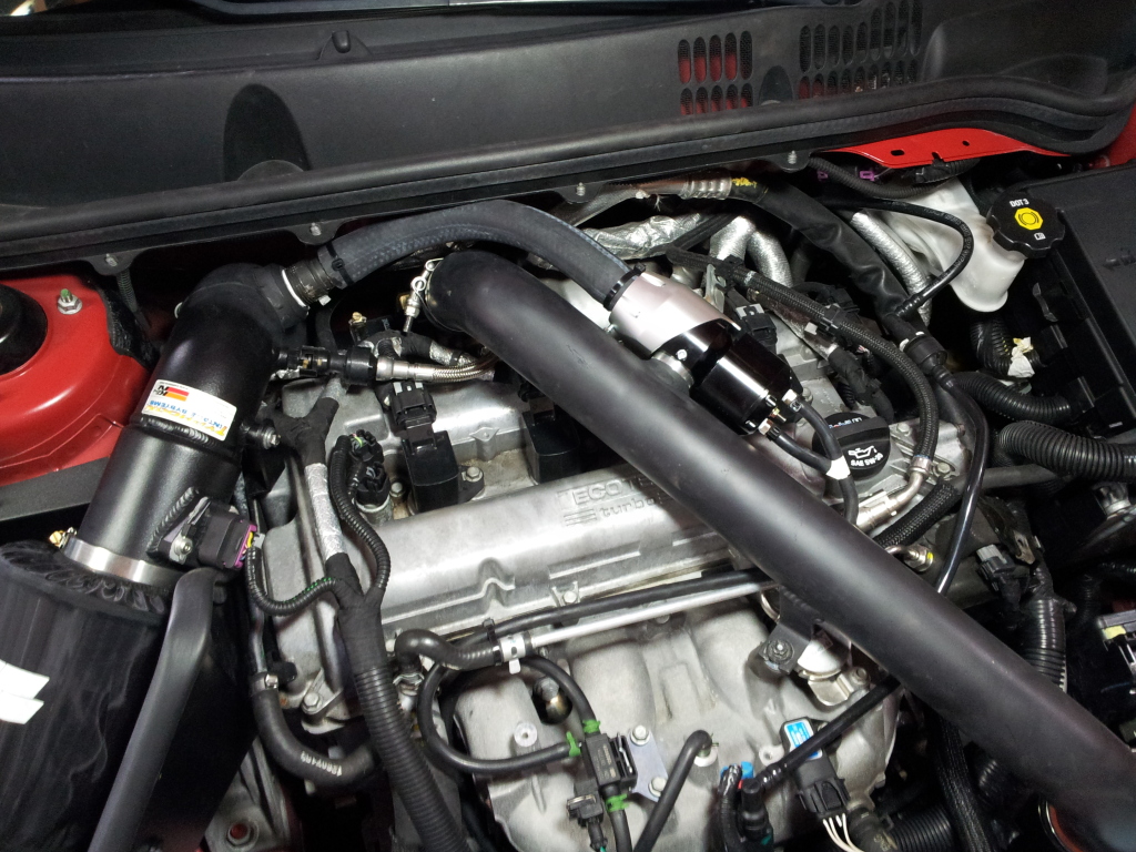

Also check the little solenoid that's on the intake manifold that connects to the bov. It may be faulty.

Frogs you're not talking about the evap purge solenoid, right? I can't remember off the top of my head which solenoid goes o the bpv. The evap purge was replaced 3 weeks-ish ago.

Bottom of this picture. The thing with the three little green clamps on it...

Ok, got it. Is there a way to test it somehow?
Personally I would make sure the plug is connected securely and flush. Make sure the vac lines are all in good shape ie no kinks and what not. You could even try buying a new one and seeing what happens. I don't want to advocate throwing parts at it but keep that in the back of your mind if the other things don't pan out.
