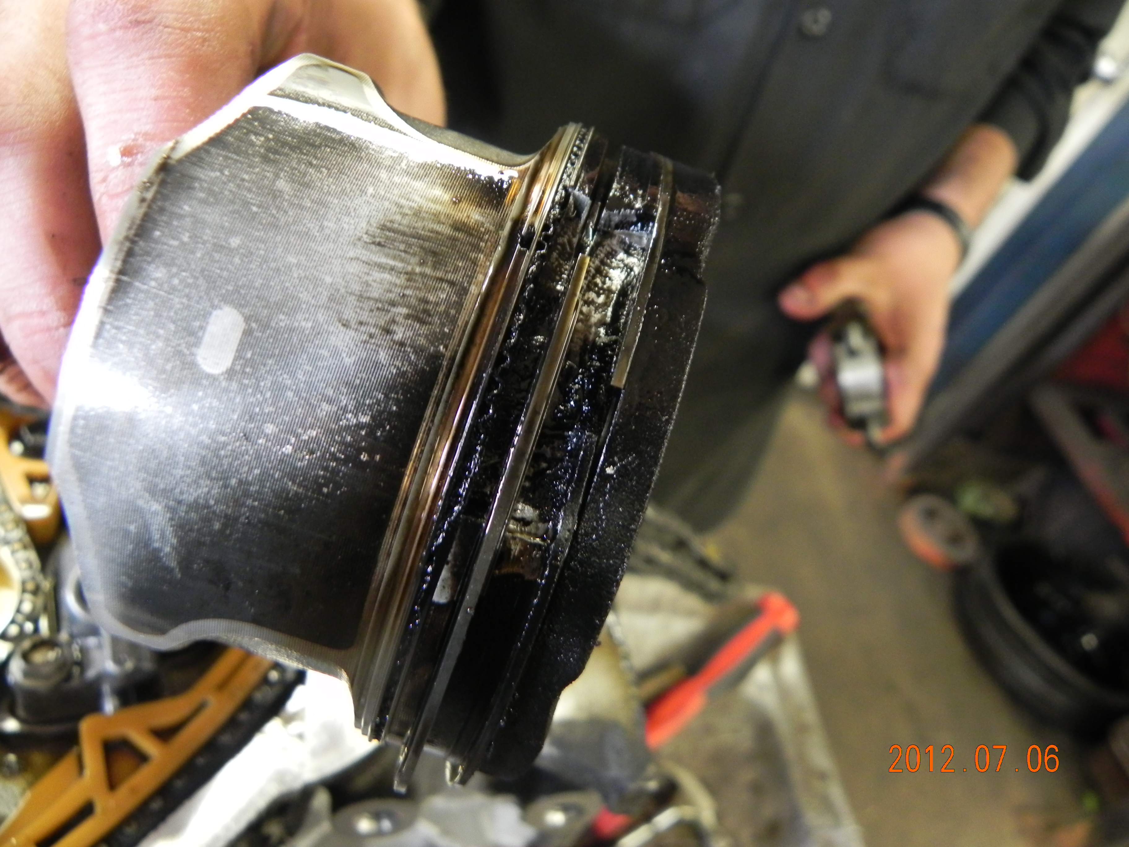

tune. talk to term. these cars in colder weather pull like a ****, and with winter rvp gas its not good at all/at all. My wntrbtr2 pulls like a John Force funny car these cold mornings, i love it, but the fact is stock tunes are fail safe. Edgy tunes are more problematical. So drive easy and get onto term toot sweet.
PS the pcv will fix that oil but pay attention because my guess is with detonation you are getting a lot more blow by and that is not good. You need undamaged piston rings and ring lands.

did I say I am a GMS1 fanboi?
if you get my drift....
