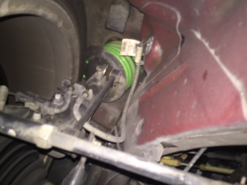

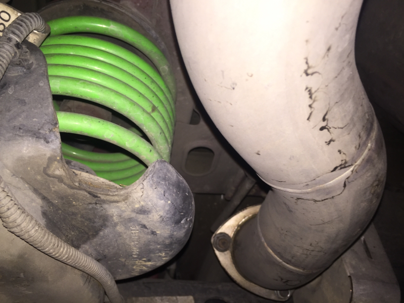

Actually I take that back the guy that had it before me put some type of springs on it, just have no clue what they are, I'll take a picture in a sec to see if you guys know what they are lol

Front and back springs.

IDK what brand those are, but being fully compressed like that is not good for handling. I'm sure your car is low though.

Well it was on the ground when I took em, it's not too low. Back looks almost stock front is pretty low
