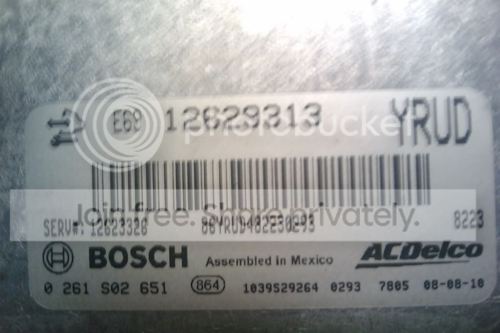

Can someone confirm asap that i can run a 09 SS/TC PCM on my 2010 SS/TC
Here is a pic of the Data Label
Thanks alot

You can. I'm using an 08 one in my 09. You just might need to follow the directions I posted on the first page.

don't know if it'll help but here is my label from an '08:
