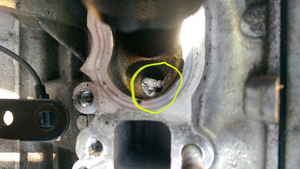

LNF bogs down under hard acceleration
I can only imagine how bad valves with 120k are. Mine had a quarter inch of build up at 58k.

How do you clean the valves? Seafoam?
Old Jun 4, 2015 | 04:33 PM
exninja's Avatar
Joined: 02-20-09
Posts: 6,268
Likes: 419
From: UT
You have to pull the intake manifold off and blast them with walnut shells, chemicals and a brush, or a combo of both.
Costs 100-200 dollars depending on what tools you already have. Takes about 2 days of work. It's not hard but it's not for people with no auto skills. Should be someone in socal that could help though.
