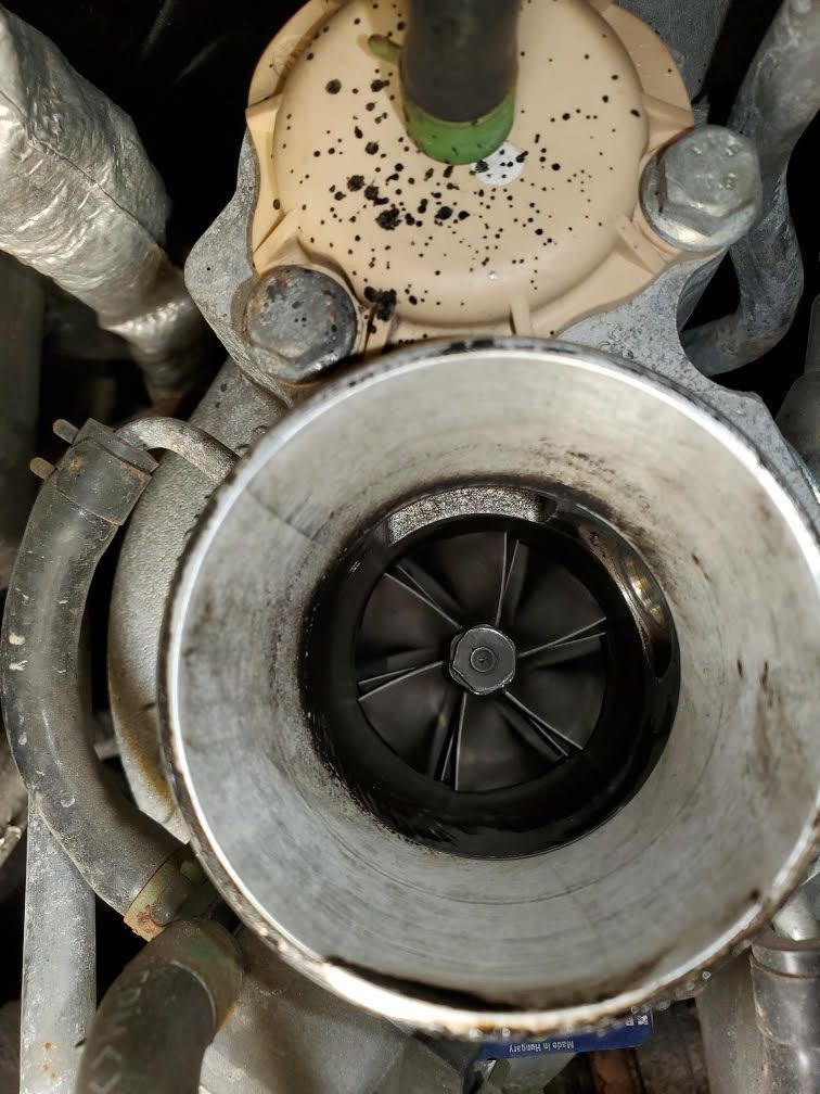

I took the hot side charge pipes off and found no oil. I checked the intake and found no oil. Both were very dry with no residue of oil.
The turbo has ZERO shaft play. The turbo looks good I think?
I'm no expert but I think maybe the BPV is stuck open?
Any tips would be greatly appreciated.

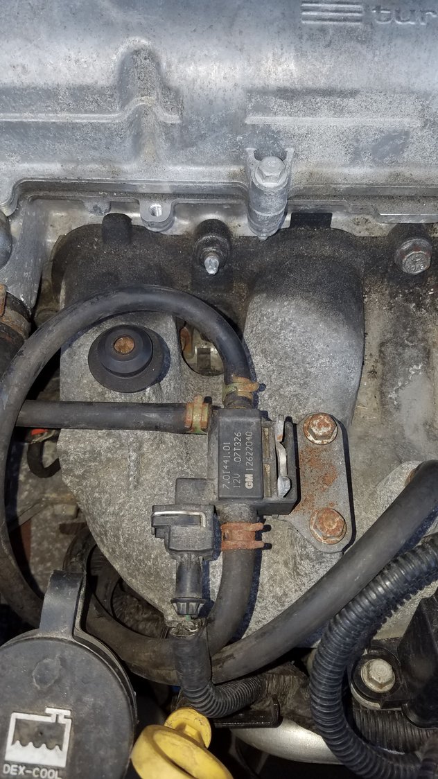

Check the bpv solenoid, the one that sits on top of the intake mani. I would only hit 5 psi. I checked everything and decided to bite the bullet and buy it from the dealership. Swapped it out and back to 25 psi. Headache solved.
