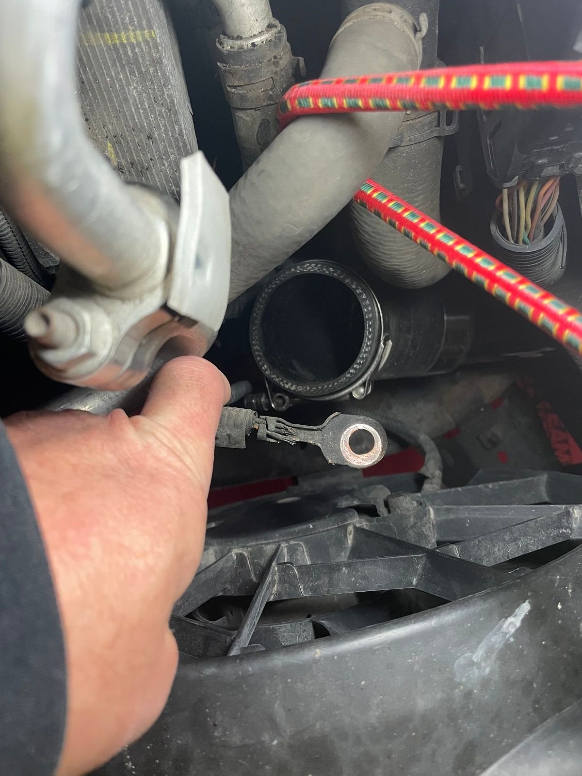

I verified this by figuring out how to hot wire the car by myself;
Essentially the starter relay grounds via the loom which connects to the PDB, and if that relay cannot ground, then signal is NOT sent to the starter.
Look at this high quality ECM/PDB ground junction (spoiler: all Cobalt's use this)
That little 18(?) - 22(?) gauge wire on the bottom...
That was the culprit the whole time.
Here... Let me bend it out of the way so you can better see how it essentially fell off after being in service for a little over thirteen years:
So after getting that figured out, all I needed to do was button everything back up, then find what I screwed up - fix that, and we're back on the road.
Well, after cutting the end off, cleaning it up, soldering short extensions (in the same gauge as the existing loom wires) into that wire coupler, and reconnecting it the the loom...
Speaking of things I screwed up, somehow I managed to bend the #3 injector pin when I was putting everything together - that would explain why the connector was fighting me so bad to lock!
Hopefully my headache, and what I've shared will help someone else with a no-start cut straight to the chase, and get their car fixed in no time flat.
