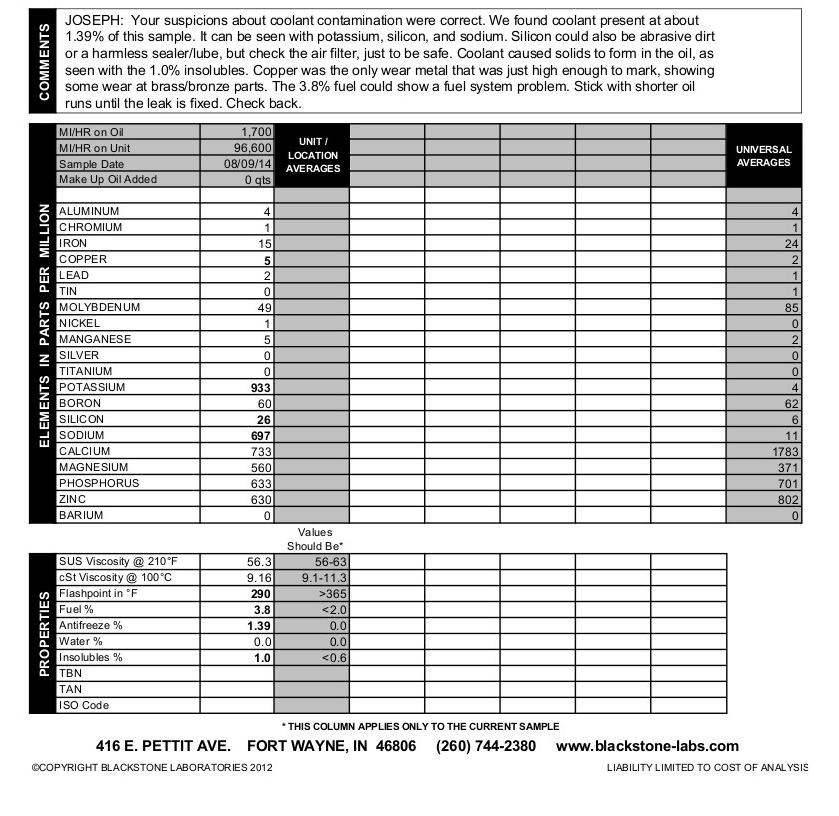

Update:
Results of oil analysis have returned. Although I couldn't smell it or see it there was coolant in the oil. Around 1.4% by volume with only 1700 miles on the oil.
I have come to notice that if the car is driven with a light foot the coolant takes a very long time to go down. Whereas getting into heavy boost will drain the overflow bottle quite fast.
I talked to somebody at Blackstone Labs and he mentioned another thing that caught my interest. He said that in the past he had seen some ecotec engines with small amounts of coolant ending up in the oil and the source ultimately turned out to be the water pump.
I believe the pump is driven by a chain under the front cover, but the body sits on the back side of the engine. I just assumed that if the pump was going that it would leak externally...is it possible that it could be leaking into the sealed front cover and then getting into the oil pan through the balance shaft bores or some such?
Additionally how would one check on this? I see an access hatch on the front cover that looks to be approximately over the pump pulley. Can I remove that cover and then run the engine or is that cover there for another reason?
