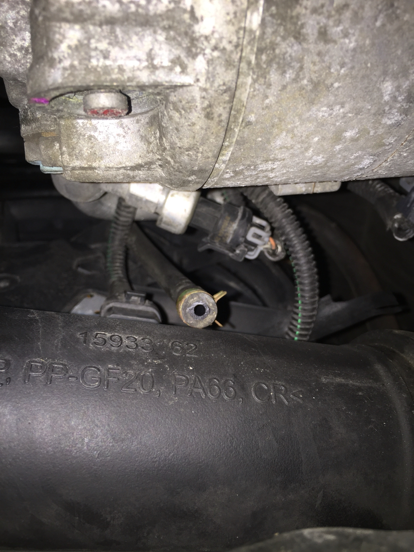

I also noticed this when I got under the car. It looks like it was cut. Any idea what this is?

Looks like a bpv line going to the vacuum tank
Old Aug 3, 2016 | 08:49 AM
Yeah it looks like the nipple broke off. Definitely could be your issue.

it looks like the vac line to the lower charge pipe. Mine broke off a while ago. have to replace lower charge pipe. If you look at your photo you can see the the stem in the line still. Your going to throw a code, it doesnt happen right away but it will happen. Took me a few days to a week of driving before I saw a code.
This photo was taken from underneathe the car looking up right? Take an above photo looking at the same vac line. You will see a pin hole next the to connector on top of the lower charge pipe I bet.. So basically you have a boost leak.

Joe is right in thought it looked like the vac tank but it seems more likely to be the one going to the chargepipe

Time to replace with ZZP lower CP. I had this exact issue on my Lower CP and it threw a code eventually.

Damn. I wonder how that happened. Will I need a new hose line as well?

if you can get that plastic nipple out of the line, then no. but I got a new line just in case.

That's a good idea... Do I need a whole new charge pipe because they plastic piece broke off in the hose?

The zzp pipe was pretty simple to install for me, taking the stock pipe is easy but it's a pain to move around to take off. You shouldn't need a new line just take the plastic out if not I'm sure it has enough lag to cut that small portion and connect to new pipe

you could probably get the plastic stem out of the line by screwing a screw into the opening of the stem and yanking it out lol. If theres enough slack you could probably trim it. Try the screw part first. You may be able to tap the stock lower charge pipe you have with a new brass barbed stem as long as nothing else looks horribly cracked.
Probably best to replace tho.

This happened to me. Drilled and tapped the LCP and got a hose barb mounted in it with RTV around the threads and the top. Thing PULLS now. No CEL for me and I was driving over a month. Couldn't figure out why it wouldn't boost after doing a few highway pulls and the bpv would open at 15 and drop to 10 and fluctuate between 10 & 15 at WOT. Fixing the LCP was easier for me than buying a new LCP because it's my daily. Took about an hour and a half to do and I needed to go to a plumber outlet for a 1/8" hose barb. I was able to remove the lower charge pipe plastic thing and took it with for size reference.
