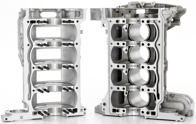

So as far as I know. The LNF was pretty well done with production by 2011. I May be wrong. I have a service manual that shows how to decode the engine which I think is ridiculous cause is a bar code sticker. I was able to make the numbers out on my LNF enough to tell it is a 2010 motor. Weather or not it’s a porous block is a crap shoot. I’m probably just going to throw in the LDK and keep it around 400 if I can even get that. Maybe if I get ambitious I’ll do pistons and rods. Any chance they can come out the bottom of these engines with the crank removed. If the engine was on a stand?
nope, tried that. pistons must come out the top. my dad didn't believe me when I was disassembling my LNF. boy it was a pita to get the rings lined up so i could slide them out the top...
Yup, the main bearing webbings are in the way pistons must come out the top

Thanks for the replies. So from what I’m seeing they should be able to come out bottom. Once you split the lower case and remove the crank. I really haven’t any experience with this motor to this extent, it just looks like they can with the crank removed and the engine on a stand. Maybe it’s more work than removing the head? I’ll figure out what I want to do when I get the motor. Seems the easiest route is to find a gas station that has E and a good tuner. Just trying to plan ahead if I ever decide to really push power.
they won’t come out the bottom. Only out the top.
