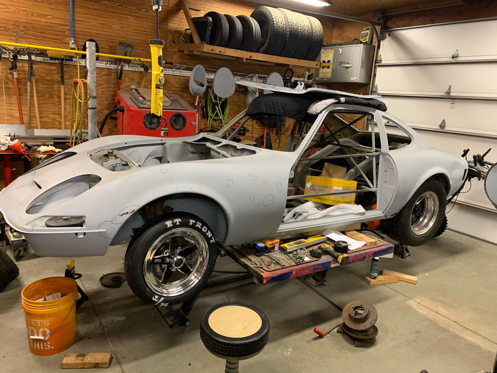

Hol' up. I just read the username. You LNF swapped an Opel GT? We're going to need pictures... lots of pictures.

You should start a build thread on here if you don't have one elsewhere.
Old Mar 26, 2020 | 02:02 PM
BlackielawlessSS's Avatar
Joined: 10-03-13
Posts: 18,401
Likes: 291
From: Haslet, TX
I dig the heck out of this build! Sub'd for more progress!

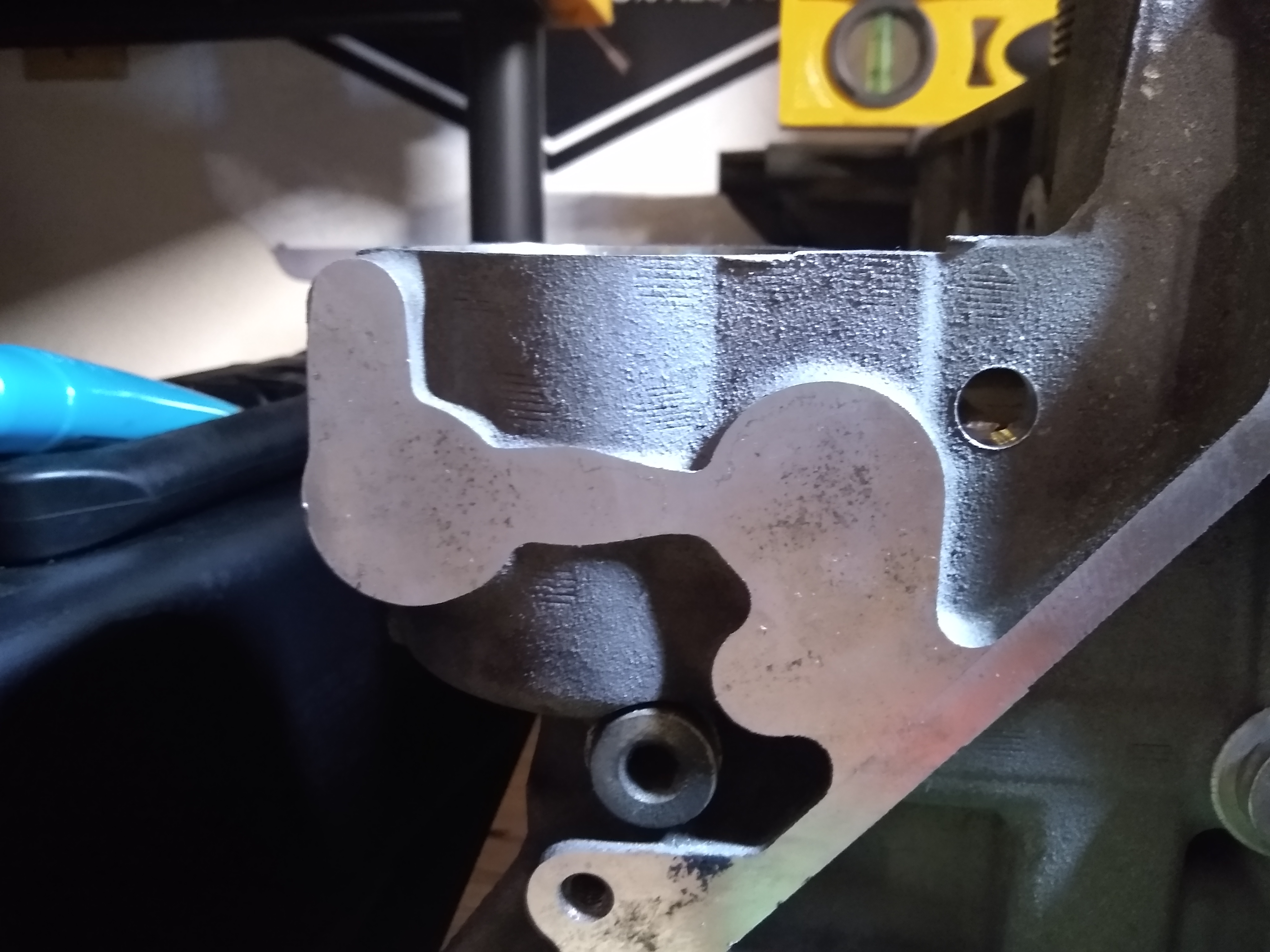

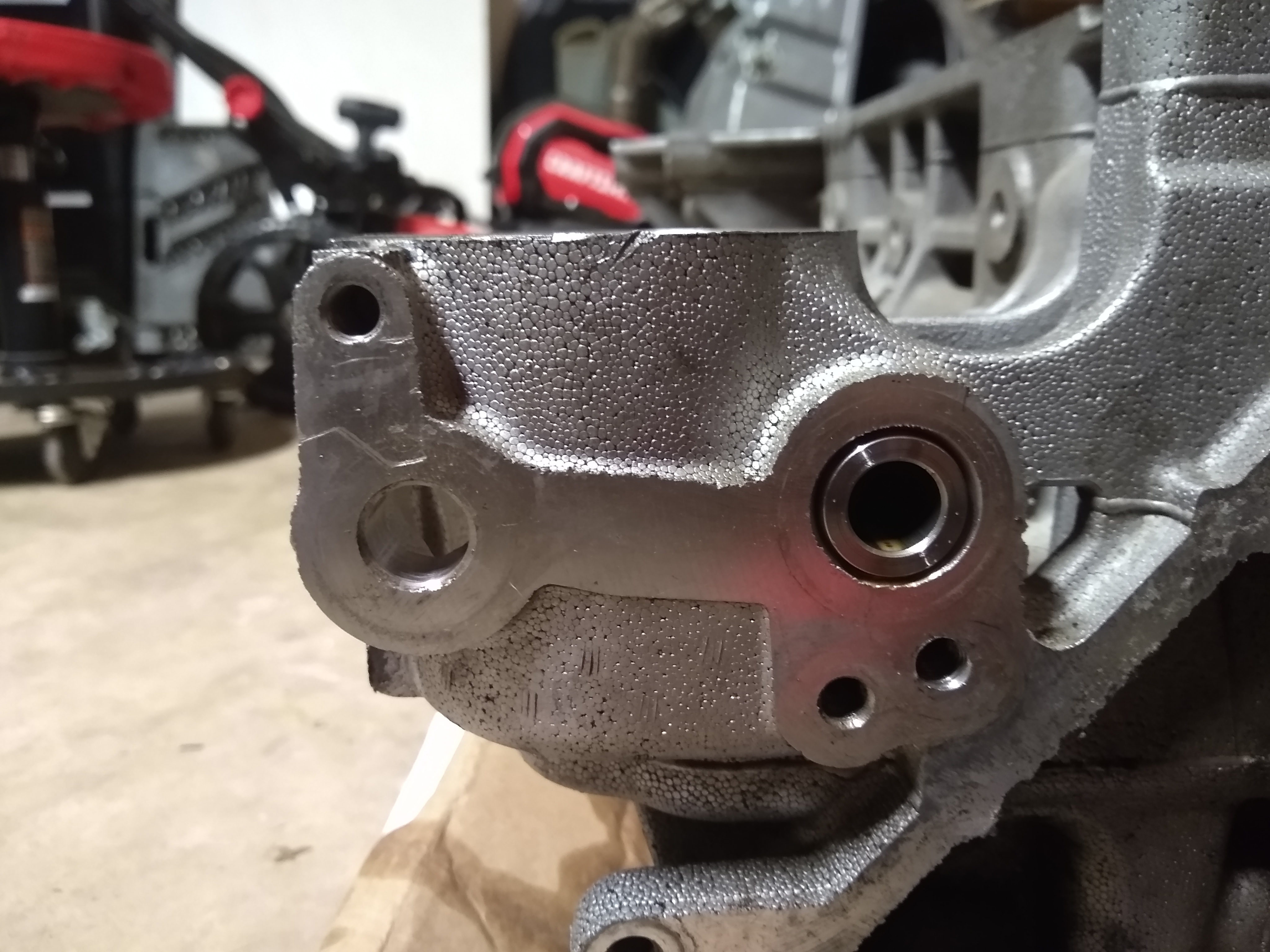

So these first two pictures are of an LNF:
The port on the right, you can see the sleeve/tube that I'm talking about.
And this view shows you how it crosses over. I BELIEVE this is the oil feed to the oil filter area. In cars with the oil cooler, this sleeve redirects to the oil cooler first, then it dumps in the second port (left one from the above image) to go through the filter.
Below is a 2.4L that came from the factory without an Oil Cooler. You'll notice the lack of machined ports, as well as the missing sleeve.

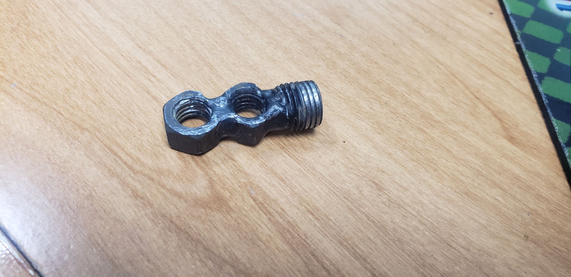

Thanks for the photos! Have you taken this tube out before? I don’t see where it’s pinned into place anywhere. I wonder if it is pressed in?

I think it's just pressed in, but I haven't taken one out to know for sure.

The tube is pretty easy to take out. I tap it to 1/4" pipe and then use an adapter I made that screws into it and then slips on the tip of a small slide hammer. One or two pulls on it takes it out pretty easy. Its not really a press fit but it does have 2 o-rings on it that are typically stuck and require a jolt to break free.

I was thinking that it most likely had o rings and pressed in. Thanks for you input on this subject! I appreciate the feedback from everyone!
