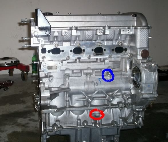

what are the 3 plugs on front of block under intake mani? are they oil galley plugs or coolant passage plugs?

The blue circled one and the two next to it are oil galley. Same goes for the other side. Thread is a 1/8" NPT, you'll want one of these if you want to add an oil sender onto it.

ya I knew all that just wanna make sure the one on the front is the same. and ya I have on on the back with a 3 foot hose to relocate it, cause the sender right by the exhaust gets fried pretty good. so I'm putting it in front on my new motor. just little room to work with on the front.
