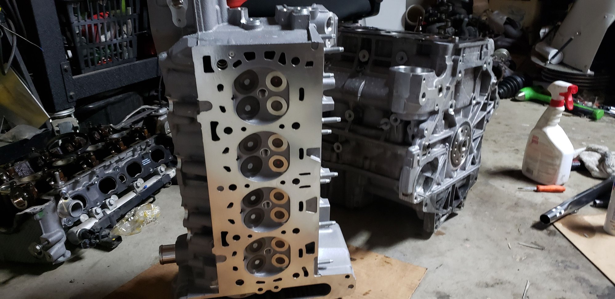

I was going to post a picture of the car to start but its just a silver SS. We have all seen one already. It looks like all the others, I promise. Most of you have seen the process of removing an engine, so let's just skip that too.
What we are jumping into is the mess you are left with when the engine gets torn apart. Like so....
That was last night. I got off work tonight and went straight to engine building. Side note - I had everything cleaned, honed and measured at work today. I put about 2 hours into the build tonight and we are left with this. I don't mess around when it comes to engine building. They fly together.
Yes that is right, from bare block to almost long block in 2 hours.
