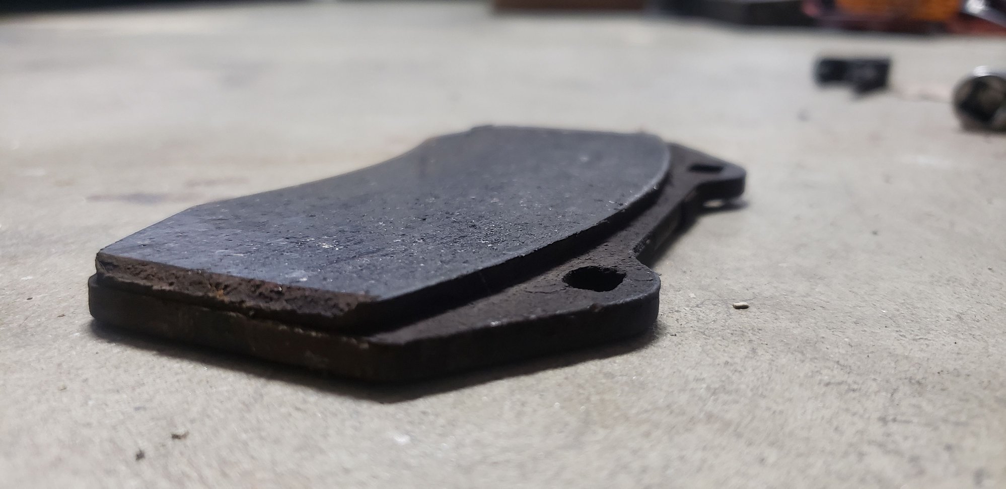

My front brakes were making a funny squealing noise, so I replaced them. Brembo/gm pads and centric blank rotors. Plenty of life left on the duralast cmax pads. Rotors almost look new...

Got the rear brakes done last night. They were in better shape than the fronts. Same Duralast Cmax pads and unknown rotors that were rust pitted. Now I just need to get someone over to help me flush the fluid and brakes will be considered done. Tonight, I should have time to get my evilbay exhaust on and then next weekend will be the front end refresh and spring and shock replacement. Not looking forward to that part. I at least have tracking numbers on all the final parts so they should be here next week.
