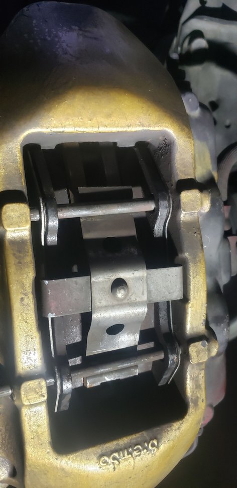

Titanium is a horrible heat conductor. So these shims help out with heat transfer to the caliper so it keeps the fluid colder. Mostly only needed for race applications. I do plan on tracking the car so figured they would help. I run a set on my evo too.

Probably was a waste of $120 but whatever. If I do ever track it, then it will be worth it.

People in the S4/S5 world have reported good gains with them, so I doubt that they're too terrible of an investment.

I really like the OEM pads for street driving so far. No complaints in that department. My shims showed up today so I will get them installed tomorrow while doing all my other work to the Cobalt. If for whatever reason I can get into my next auto-x race, I think I will take the Cobalt to try them out. I think the Evo is going to go under the knife pretty soon so I can install my big turbo so it may be down for the next race anyways.

Had a little time tonight to install the shims. No difference yet, that is as expected. Tomorrow it shall get Lucas full synthetic 10-30 and some work up front. More to come....

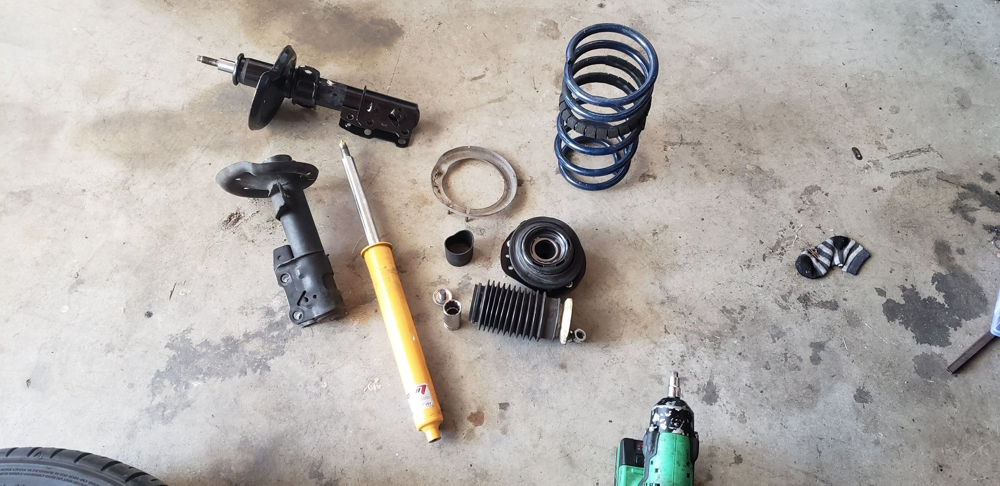

Done working on the cobalt. Still have to take it for a test drive though. First off, I popped off the drivers side strut and stripped it down again. I followed konis instructions on how to cut the shock body and it was way wrong. So I cut the original too short. Ordered the cheapest strut I could find and used that as the next donor. Came out perfect this time. I also took the other sides strut apart and put red loctite everywhere since I didn't the first time around. After that, I put the new sway bar end links in. Then done. Ohh, also changed the oil for the second time on the new engine (2500ish miles). Sending out an oil sample for analysis.
