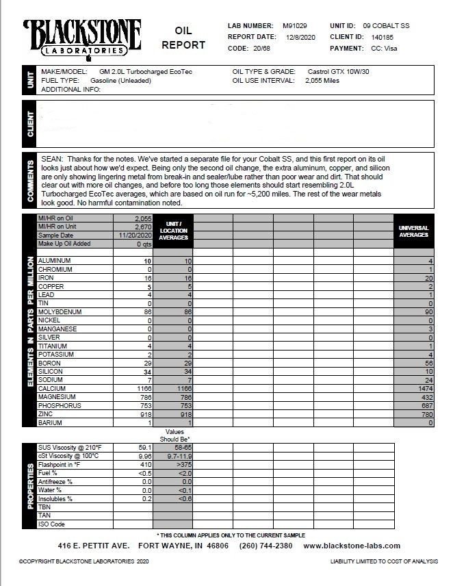

Finally sent my last oil sample out to get analyzed. Hopefully it comes back with good results. That tis all for now. Now I need to get back to working on my Bug.

Got my oil analysis back today. Turned out as expected.

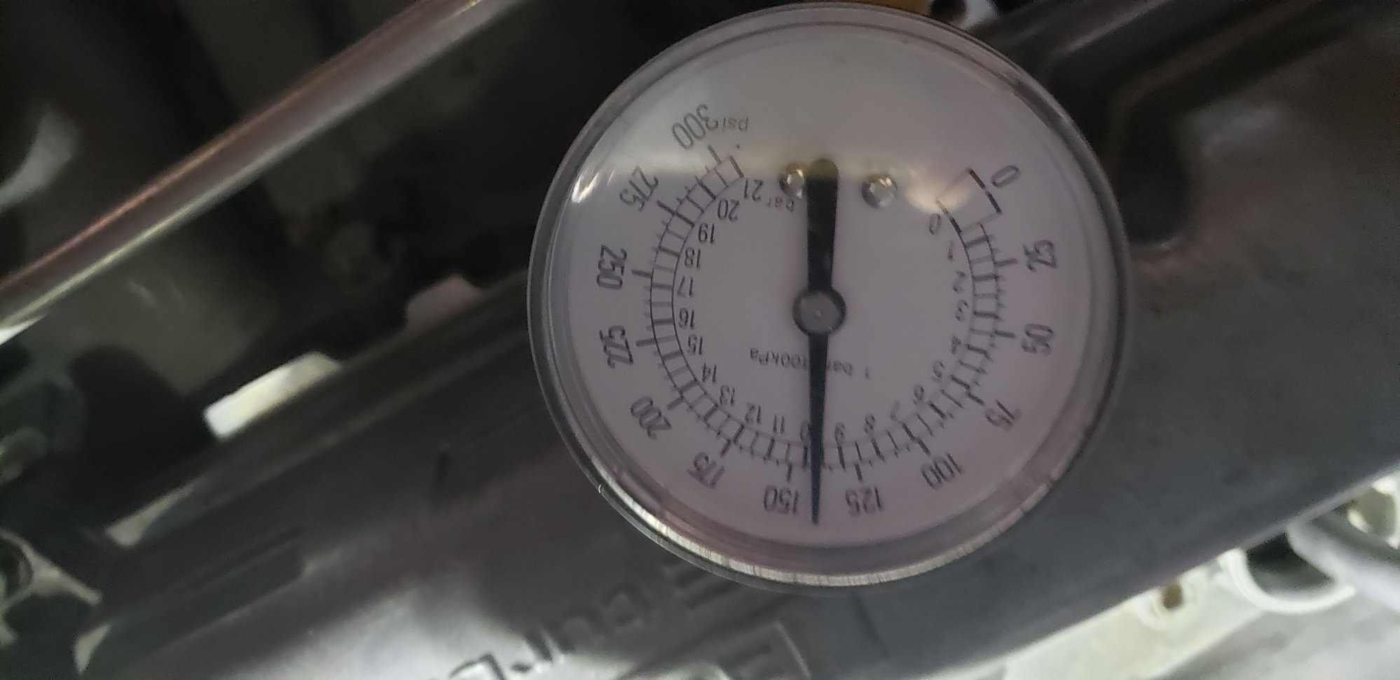

Small update. I bought new spark plugs back when i built the engine. Then they went missing so I put the old ones back in. They seemed to works fine so I didn't care. Fast forward to last week. Found the plugs! Decided to put them in tonight. Also figured while they were out I would do a compression test. Just turned over 3000 miles on the new engine so why not. On my 10 year old China special compression tester, I got 142ish psi across the board. Pretty much the exact same for each cylinder. I'm good to with that. Time to keep driving it!

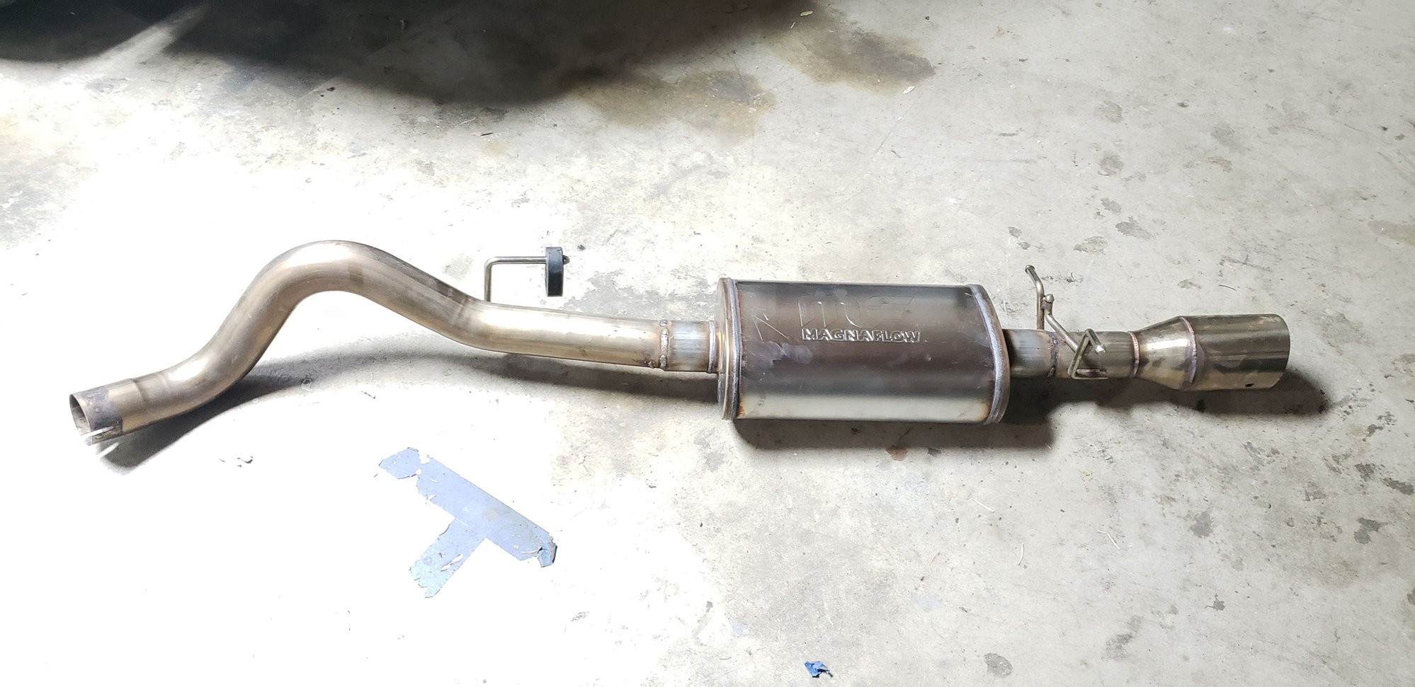

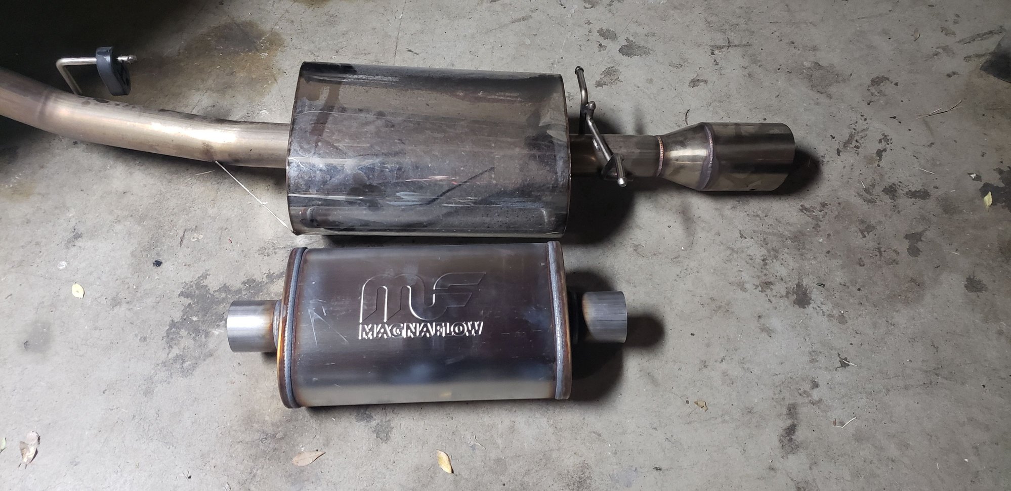

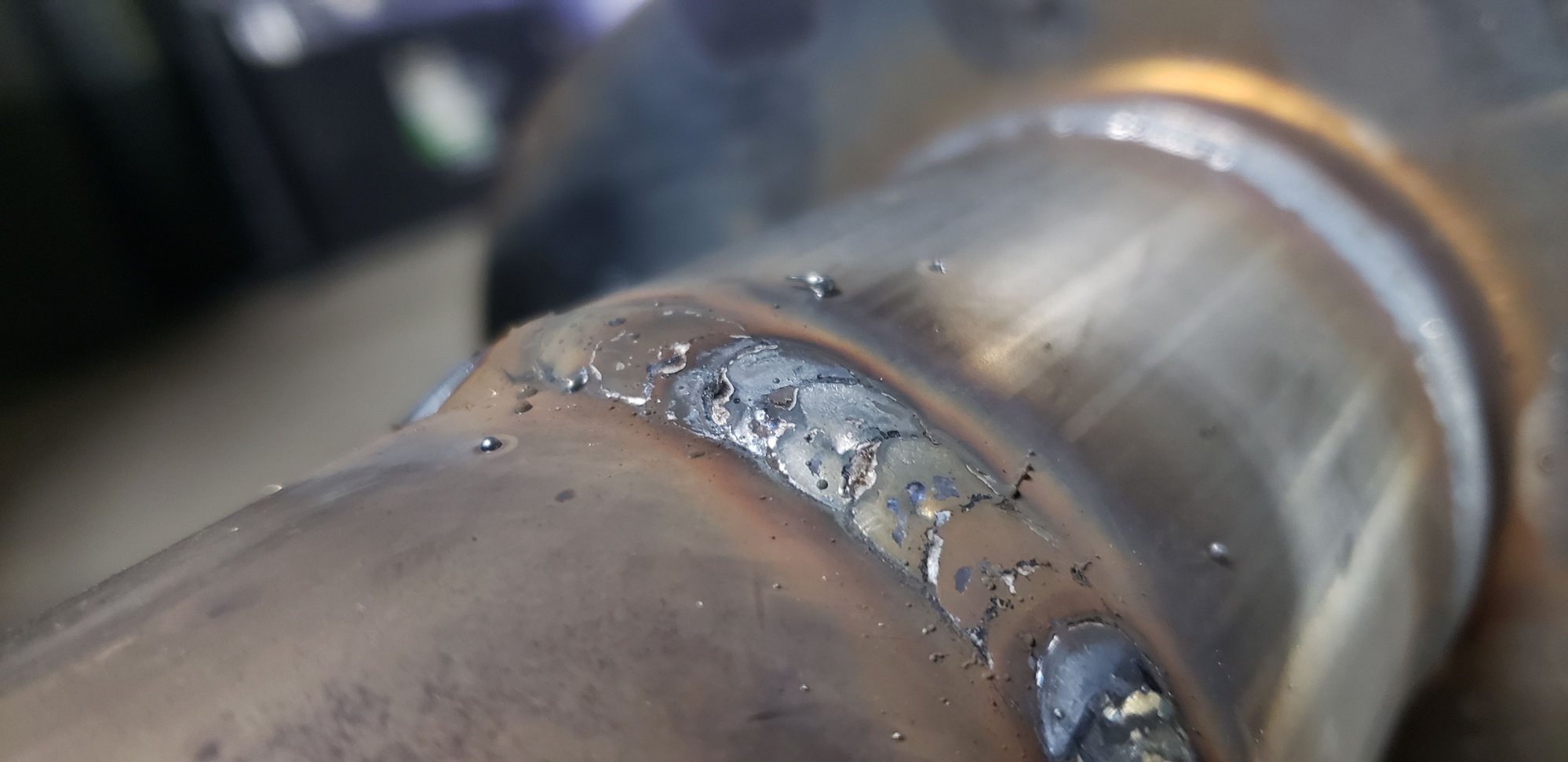

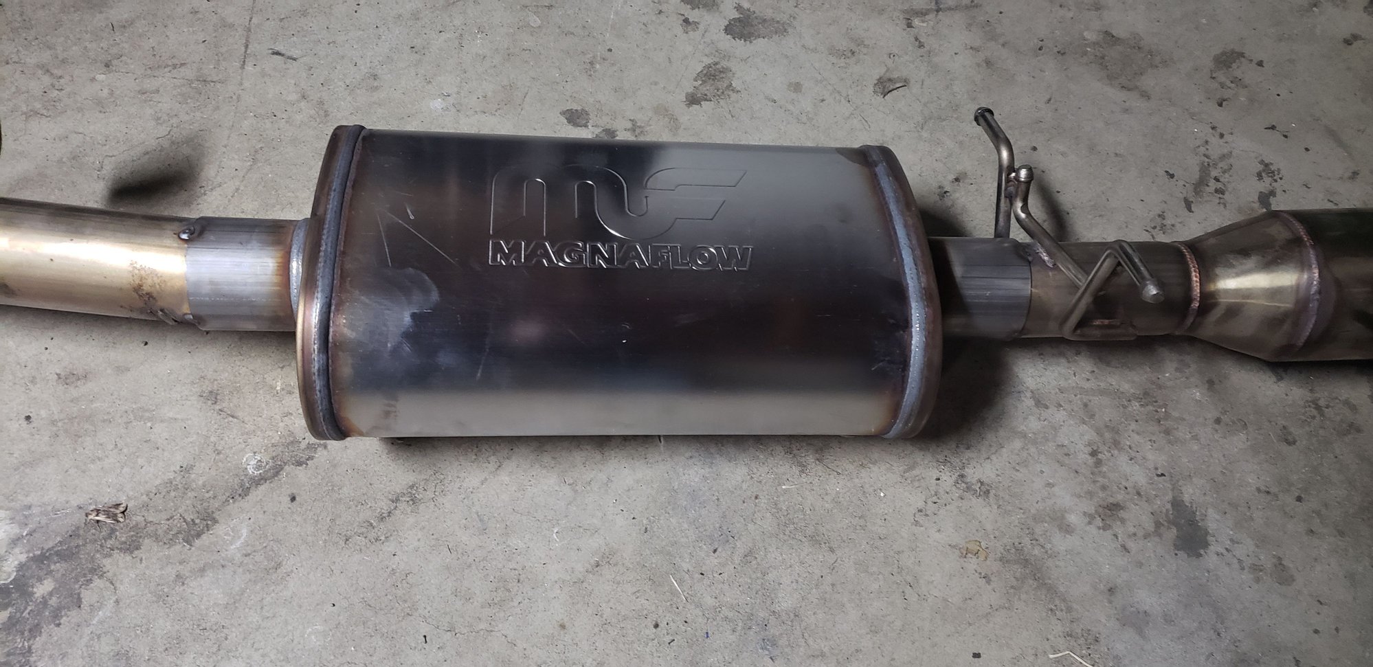

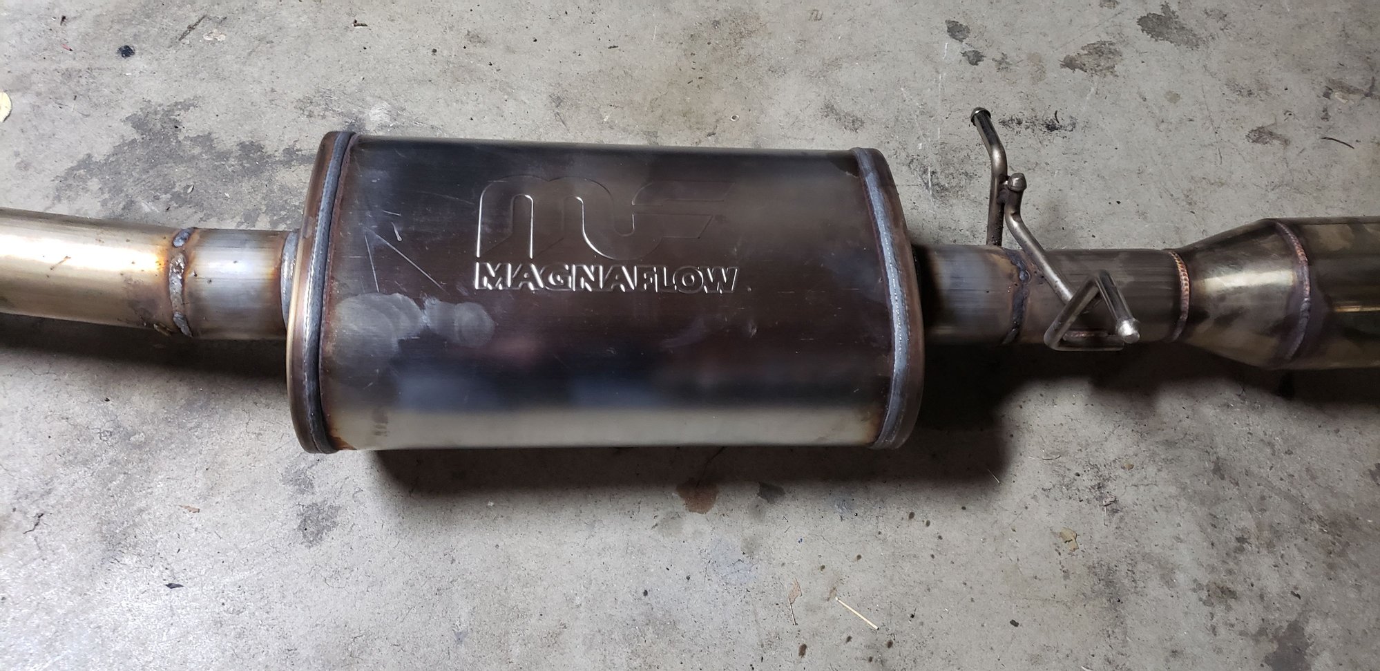

Another very small update. My wonderful china-bay exhaust only seemed to last somewhere between 4-5 months. Muffler blew out and was rattling like crazy. Ordered a magnaflow to replace it. Wasn't a bad job. Got it all done in about a hour and a half.

I like the way MF sounds on the ecotec motors!

Its pretty quiet now. I dont mind though, better than loud. At least it no longer sounds like marbles in a can.

Still windy and another day of no power so the video is on hold. But I do have to say, I think the car is actually too quiet now now that I have driven it a few times. I am guessing its a hair louder than a stock Cobalt. Might need to cut out the resonator next. The best part is that there are no more clunks and rattles (well besides all the ones up front ). I thought I had something clunking in the rear but it ended up just being the piece of junk China muffler flexing and hitting the bottom of the trunk. I dont think that I mentioned earlier that the China muffler had no packing in it. Literally just a paper thin shell with a perforated tube in the center.
