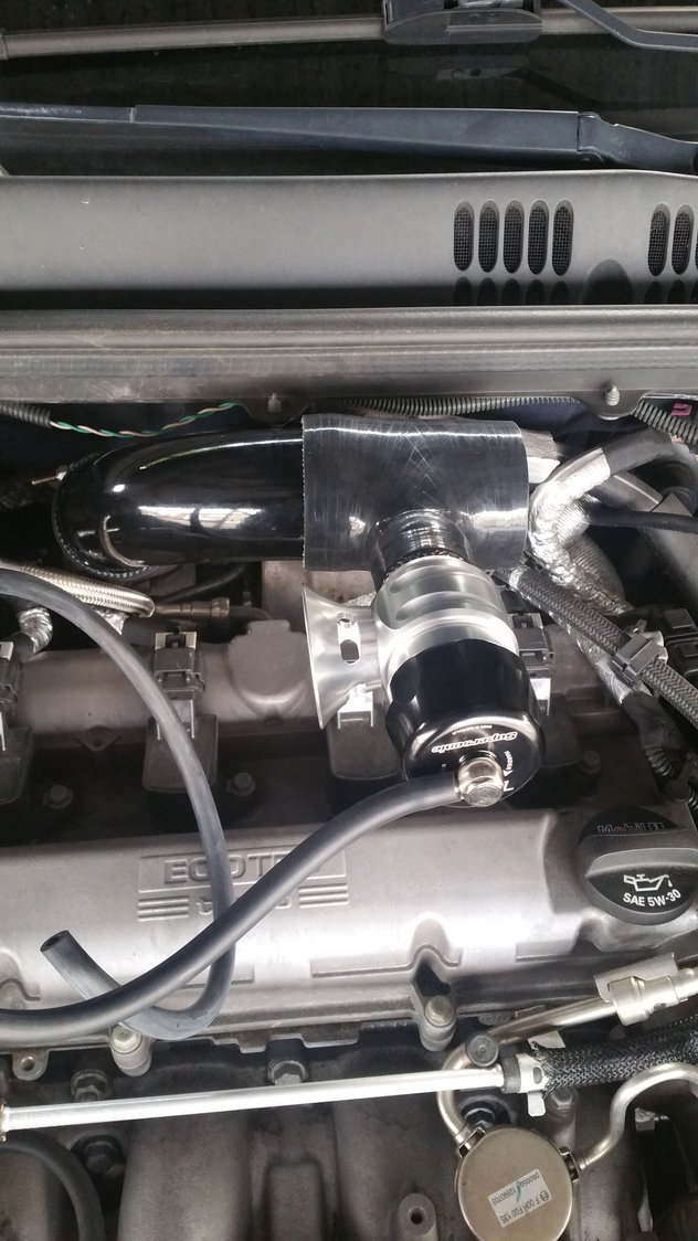

I just installed the hahn charge piping and i just got the hahn billet bov supersonic to atmosphere, I want to know if it will run properly by just putting it in, or do I need a block off plate? And yes I will be tuning the car again.
I want to put the bov here I have a pic of where it will be installed I haven't put it on yet because I was hesitant on doing it before I asked about the block off plate for the stock bpv

You need to get a good block off plate like the treadstone. Also you need to relocate your maf if vta.

ya ull need to relocate ur maf to tune for that

I got the block off plate, and trifecta has a tune that doesn't require a maf relocation, I'm installing it tomorrow, how do I set up the vacuum lines for a block off plate? Do I hook the old bpv hose to the bov simple like that? Or do I run to the intake manifold and close off the old bpv hose?

To bad that trifecta tune is bs.
I people should really read on this forum. Let me ask you something op.... your maf reads all the air coming into your engine courtesey of a maf sensor. Then it goes through a pipe, intercooler, another pipe and into your tb and intake manifold.
Now when you add a bov all the metered air goes bye bye. Do you really think you can tell a computer how much air it just vented and what to do to compensate when it blows off? No. You can make it more driveable but you cannot change the fact that the car will go rich between shifts.
