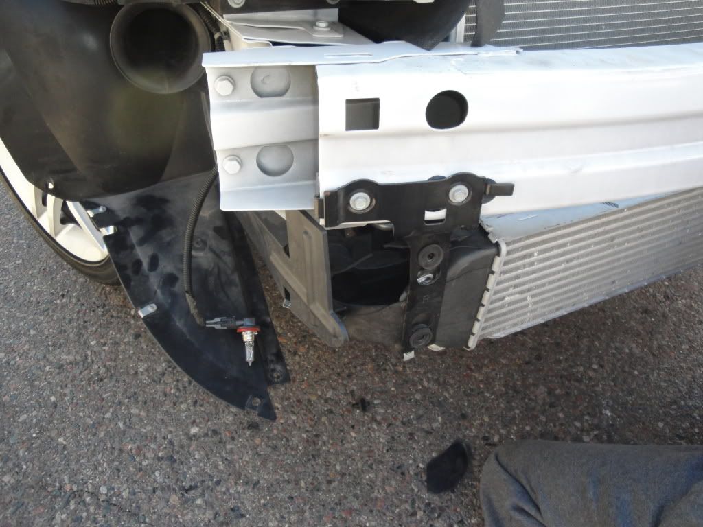

My car is an 08 with an HP tune at 20psi, ZZP catless downpipe, and a K+N drop in filter. The car has been tuned for 27k miles with zero problems up until now.
I was visiting my grandmom on friday night and as I was pulling out of the gas station I went half throttle in 2nd gear. When it hit alittle over 10psi the intercooler opened up with a loud bang and a backfire out the exhaust. The car actually drove somewhat fine and I made it home without any problems. I was expecting the problem to be charge piping related but to my suprise it wasn't.
I'm glad it happened on a Friday as it gave me the weekend to get the car back up and running. After removing the intercooler I deemed it somewhat fixable and bought some JB weld. This is my rig up just to get the car driveable this week and no I'm not expecting it to hold up under boost.
This is what I have coming minus the BOV as i'm using the stock bypass.
Believe it or not I was actually content with the Cobalt and the power it was making. Buying an intercooler wasn't even on my mind but since this stocker blew open now is the perfect time to upgrade

This picture explains why it was splitting. You've been hitting it against stuff.
I've said it many times. Pull the condensation bar and fill the holes. The intercooler will not crack if you're running stock charge piping (with the recall fix), and do not hit things. Pulling the condensation bar is one of the best ways to ensure you don't hit the bottom of the intercooler.
I hit the intercooler on the ground one time within the first 2 months of owning it. This happened 2 years later.
