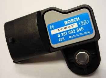

I think you may be thinking MAP sensor. If the TMAPS are bad this could cause a problem. Also something to look into, check the MAP sensors, the previous owner may have had 3BAR GMS1 sensors installed. Reflashing to a stock tune would ruin the sensor maps and could cause boost issues as well. All that would be needed is for you tune to be adjusted. I found a picture of the 3bar MAP sensor as a reference. Good luck.
EDIT... oh and the MAP sensors are in 2 locations. One is on the intake manifold in plain view when you open the hood. The other is on the cold side charge pipe, right after the intercooler. Take a flashlight and shine it down right in front of the engine on the charge pipes, you should see it glistening all pretty in the incandescent glow.

Nope, I'm thinking MAF. Our car is weird. The boost reading you see on the boost gauge/RPD does not necessarily reflect what the MAPs are seeing. The boost reading is a calculated value in our case, and is subject to skewing due to MAF skew.
You're right about the MAPs though. That's what they're there for. Both are technically TMAPs I believe, but only one is wired up with the car for temperature readings (which feeds the IAT2 info).

If they're the 3 bars, then they are both TMAPs. Motox is right about the TMAP. This has caused boost spikes before. If you're on stocker, let me know, and I can send you one to try out. I think they're pretty cheap, though.

I understand that the MAF skew can mess with the boost reading... but to have the motor boost to 30psi or show 30psi (as a false reading perhaps) is odd. That is why I'm thinking MAP issues.
OP start by cleaning all of your sensors with MAF cleaner... that would be MAF sensors and both TMAP sensors (the one in the CP and in the intake). Check the wiring to make sure everything is good to go when you have the sensors out. If you still have the problem, it could be in the MAP scaling (if the car had an aftermarket tune on it at some point that was replaced with an incompatible flash) or you have a bad MAP.
Also, I reread your posts, OP, hoping to find something I may have overlooked. When you are wide open and the car boosts to 30psi I'm assuming you hear a fairly pronounced very rapid clicking (in your second post you are saying it sounds like something is trying to bleed of pressure)... Almost like there is some lifter tick or like someone is clicking a pen really really really fast... That is you wastegate actuator and I hear the same thing. It's fairly normal on these cars Or most turbo cars with a turbo with an internal wastegate) and I have been told from multiple sources that it is nothing to be overly alarmed about.
Oh and to alleviate any confusion from my earlier post... they are both TMAPS but I interchange MAP and TMAP to describe them. That is my bad
