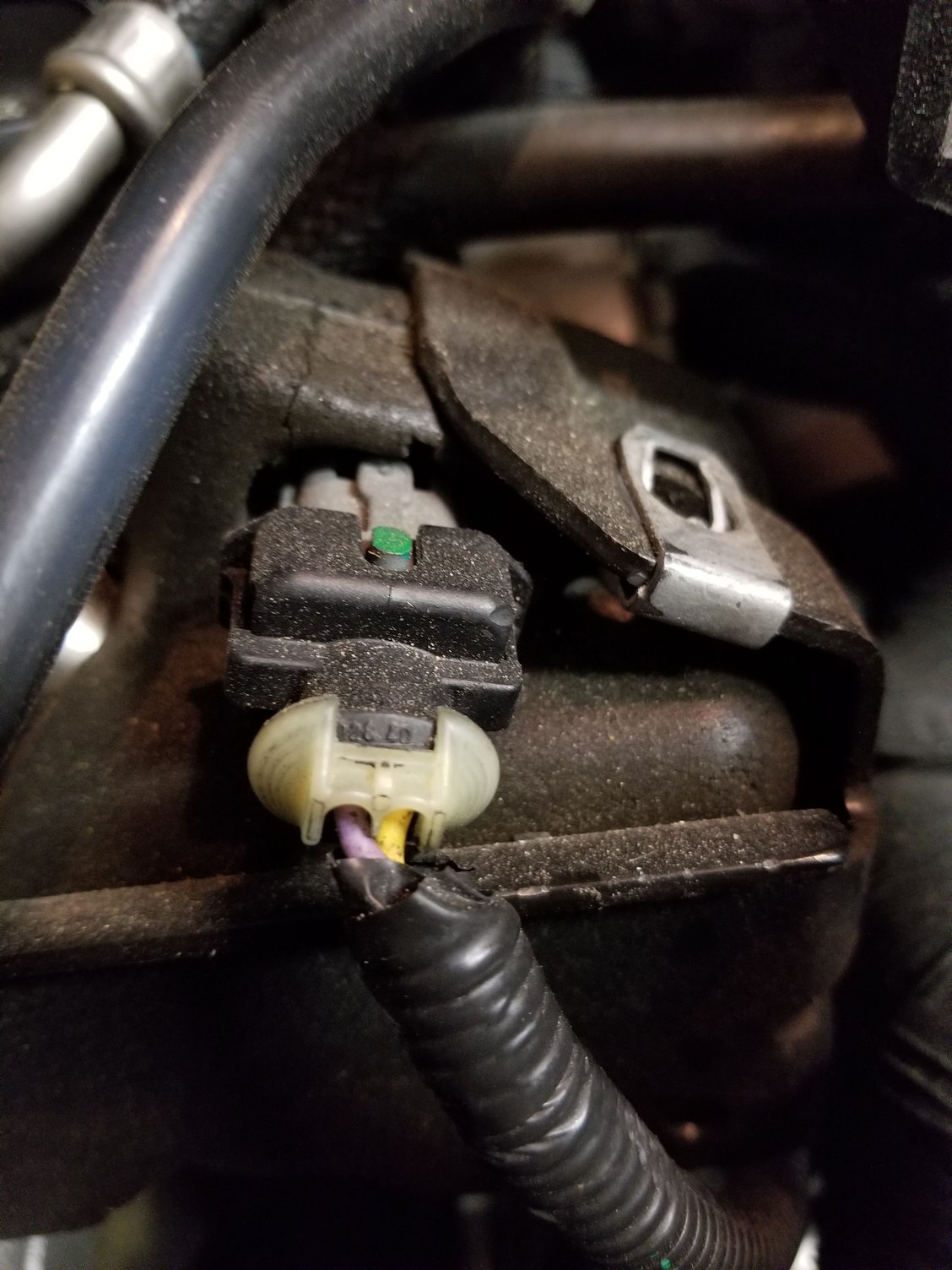

Your hpfp might be on it's way out. I forget if those are the codes for the expected pressure vs actual pressure. Log those two parameters and see if they follow. Also check the wires going into your hpfp and make sure none have worn through and are shorting.

I'm not that mechanically smart... I did log my ride home from where I had it happen, I can post the log on here? I plan on dropping it off at the mechanics tomorrow and have him look at it. I'm writing down all this to show him what to possibly look for

Wires don't look to bad.

Might not have anything to do with it but did you notice that the housing is cracked?

You should log it with Hptuners, if you want I can email you a log setup for that. Also depending on where in Las Vegas you are I'm going to be there tomorrow night (not staying long just 1 night) if you buy me a beer I'll take a look at it.
that black plastic piece isn't the actual housing, its a piece of foam for sound. Here is the pump without the plastic foam

iirc it's relatively simple. Two lines and two bolts, you just end up with some fuel all over the place
I'll see if I can find the thread discussing the wires and what the other user had to do, I want to say he had to pull the wire loom back some.
