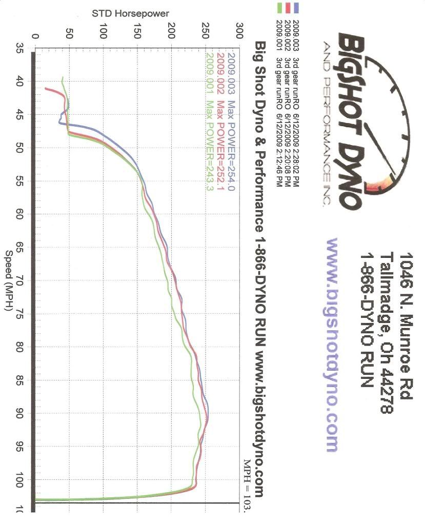

Here is my dyno sheet with just a DP and drop in K&N, no tune.

and what about after?lol
After, my last dyno was 290whp and 350wtq with then addition of CP.
