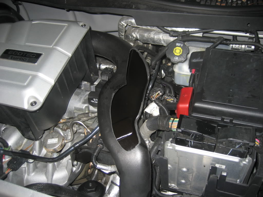

^^^^^^^what he said aftermarket charge piping prevets this:
Old Sep 15, 2012 | 12:57 PM
Big ass engine cover lol

FasterIsBetter's Avatar
Joined: 05-15-10
Posts: 3,994
From: South Charleston, WV
Yeah, its actually the HHR SS airbox. Weird huh?
