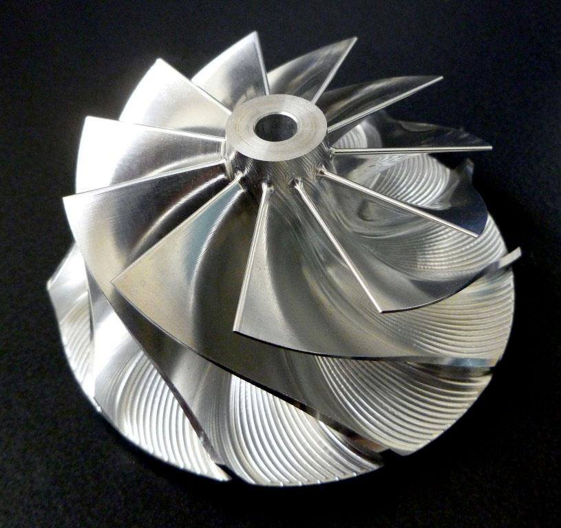

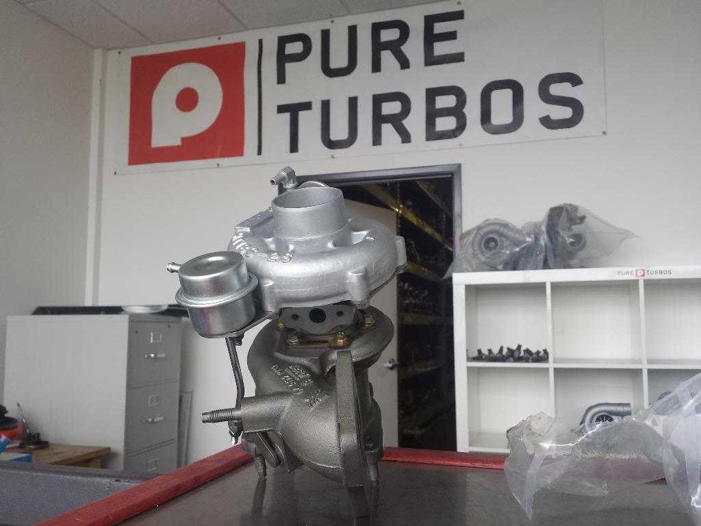

Mine is an upgrade but not from BNR themselves. I have a local shop here in Cali called Pure Turbo's. They not only do local stuff but internationally as well. I had mine completely overhauled with new 360 thrust bearing, cleaned and compressor upgraded to billet. The main difference from them and BNR.....they have a VSR balancing machine and the turbo was balanced all the way to 120k rpm's. I promise you, BNR does not have that machine. They discovered that the exhaust turbine was rubbing against the housing and that usually indicates that the turbo was not balanced. Here are some pics...

Billet wheel before installing 2871 size $195

Their facebook if you guys want more info:https://www.facebook.com/PureTurbos

Awesome work, and if i do not sell my k04, then i have a guy in orlando that has the same setup....K04-R @ TURBOBAYPERFORMANCE.COM

Charles from pure turbo's knows what he's doing. Looking forward to your results brotha.
