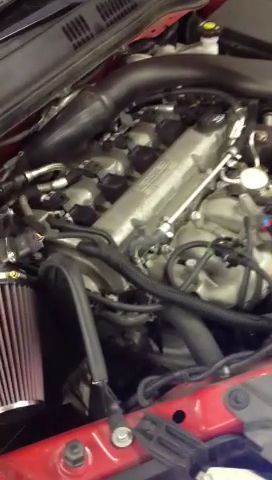

My buddy was wot in 2nd and heard a loud pop. Which resulted in 0 boost. Ok so charge piping came off right? No... Take a look and help us out. Code is mass af and we smell nothing but gas
http://i43.photobucket.com/albums/e3...4/dcc1c777.mp4
Whats going on

Betting he popped the cold side end cap on the stock intercooler. Pretty common problem.

Code is p0101 as Cobalt08ls told me. Already told them to check the intercooler end tanks and charge piping for breaks. Idk if they did or not. P0101 comes up as a maf code but more often than not it's a boost leak.

Time for new intercooler. It is inevitable and it happens to almost all of us. I didn't want to believe it when it happened to me either.

Check where it connects to the throttle body cause its hard to tell, but it's probably the IC end tank.

Easy way to see where the leak is, spray your charge piping, intercooler, and intake manifold with some carb cleaner, when the motor sound changes you've probably found it.

Make sure you have a fire extinguisher on hand though just in case or propane is a safer alternative.

Either it's the intercooler or you guys jarred loose a rocker arm or busted a lifter. Your ticking is really loud in that video, louder than I'm used to hearing.

Broke the intercooler. You smell gas because the car is running really rich due to unmetered air being pulled in to the system, post-MAF. Dude needs to calm down, pull the bumper cover off, and replace the intercooler. The dealership doesn't have to prove anything. That's BS. All "proving" anything means is having a certified technician (professional) say that the issue was caused by the driver. How hard is that?

I agree with intercooler comments however, the ticking in the head does sound worse than it should IMO. The motor is probably fine though.

Gm took the car in sat. and mike (Red09SS518) just texted me and said the ecu was fried and that its covered under the powertrain warranty
