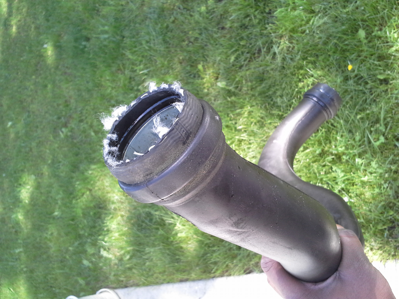

Ok so I got another question. I was checking for charge pipe leaks today and decided why not install my zzp upper charge pipe. Anyway I didnt follow yhe directions correctly and ended up cutting the stock couplers too short shown in this pic.
Anyway I wanted to know if anyone know if the zzp lnf silicone replacement couplers are the part I need for the charge pipe to work now that I f'd it up.

Yeah, the zzp silicon couplers are a much better fit too.
Thanks...just ordered them. Now I have to catch the bus to work til they get here.

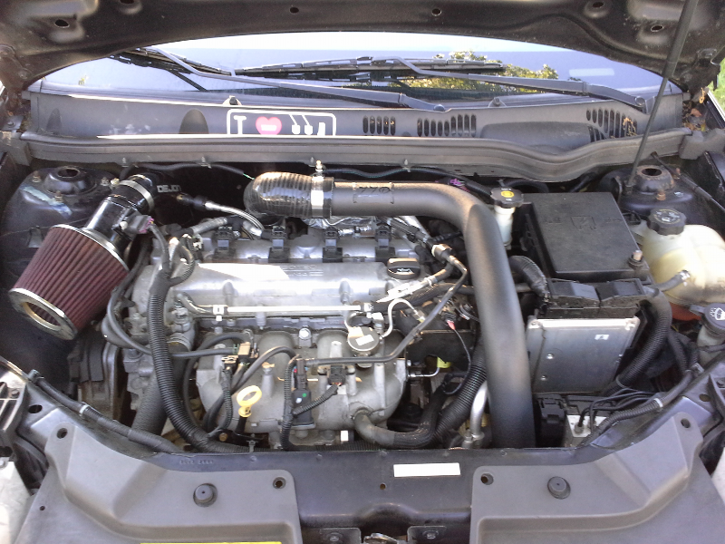

Installed zzp upper charge pipe and my ltft is getting better. Must've had a boost leak. Also cleaned maf. My dejon intake filter is very dirty and I was thinking of getting a new filter anyway. Should I get the 3" one from advance auto? Term told me the dejon is 3" and the kn is 3.25". Im thinking of just getting a 3" kn filter. U guys think that would work?
Attachment 5613
Get a AEM dryflow filter for it.
