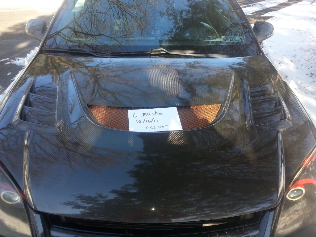

Great point on the hood. I would like to see what a hood like this one does. I'm not a big fan of the look at all but it has to make a difference in getting some circulation going especially with both fans running on high permanently on the track tune. Such a shame people are not willing to ship these things...
