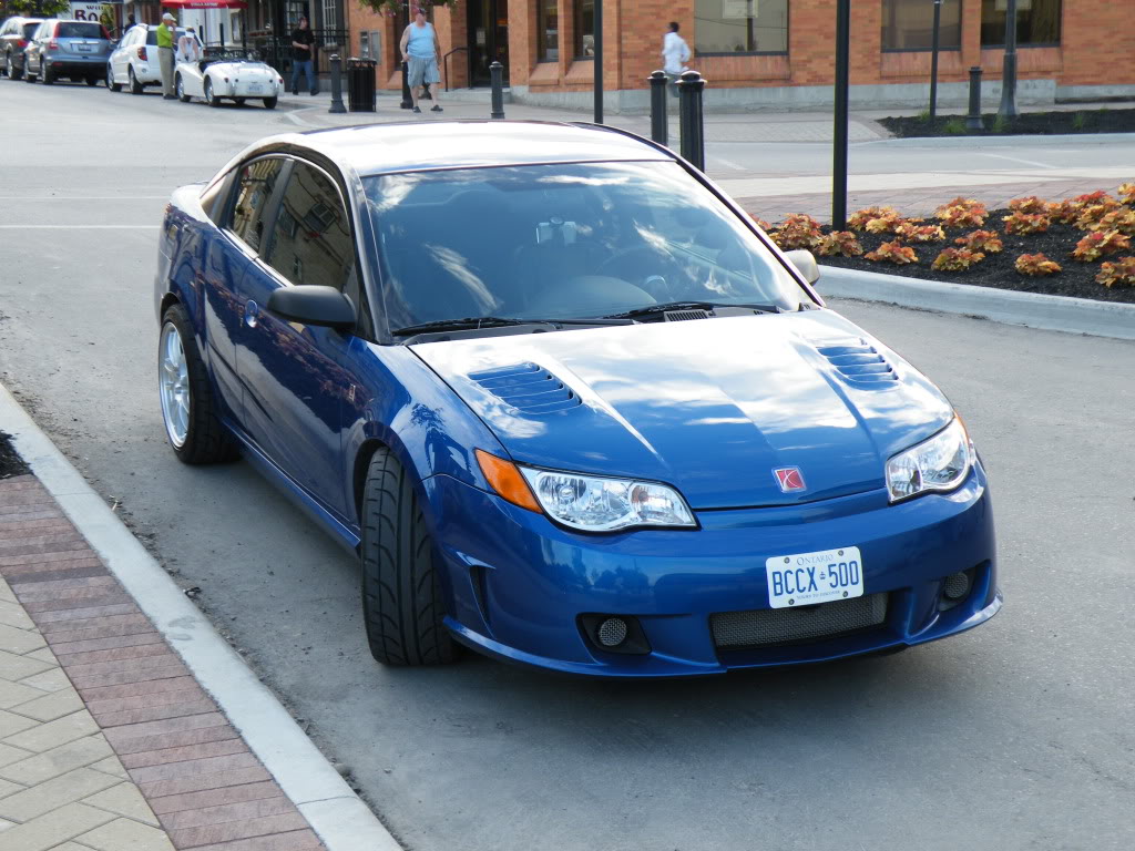

I have only once in ten years encountered track conditions where the stock radiator could not handle cooling. It was at Watkins glen and it was a very humid day. The corvettes suffered the sane fate. While it is true that the corvettes with alloy aftermarket radiators were okay
The margin of cooling corvette to any delta the delta is superior. I have built two versions of carbon fibre vented hood and the current one I have is theist aggressive and the most effective. That track day my car did nor overheat. It did run very close to the red however and normally it rubs off the thermostat. Although I changed the hood after that I have not encountered a similar day or the issue since then. For my money adding nose weight with an alloy radiator is not a requirementName:  DSCF3536.jpg
