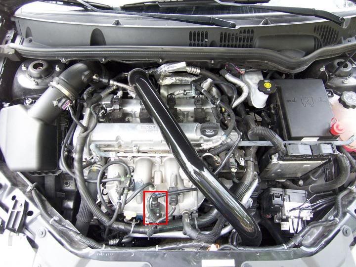

Well, that's the EVAP code and will cause random boost issues, so replace the EVAP vent valve and the EVAP solenoid and see if that helps.
Solenoid:
Vent Valve:

do you think that would cause my maf codes ive been getting and the flutter in turbo? also have noticed gas gauge speratic of a 1/4 tank sometimes,.

MAF codes can be caused by any vac leak. You had a code for the vent valve so I would say it's worth a shot

installed new purge solenoid and vent valve. valve required me to buy a new harness because they changed the valve and connector. erased codes, see how it goes, so much snow out cant get car out.
