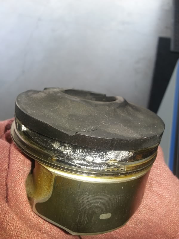

^^^Leakdown/compression test.
Could be caused by a cracked piston/ring. That's what caused mine. Do a compression/leakdown test. It will tell you almost for sure...
If you are still under warranty and let the dealer mess with it, they'll replace your ignition coils and do a bunch of other unrelated stuff first... (that's what they did for me anyways)
It could cause the other codes too (at least the exhaust one, you'd be leaking pressure through your crank case and by the turbo) if your piston is cracked.
Just make sure they machine the heads when they do it, I believe they forgot to do it on mine, and it's back in the shop now. Had them do a leakdown test, it failed (cylinder 1 lost 15%, while 2, 3, and 4 lost only 3%)
