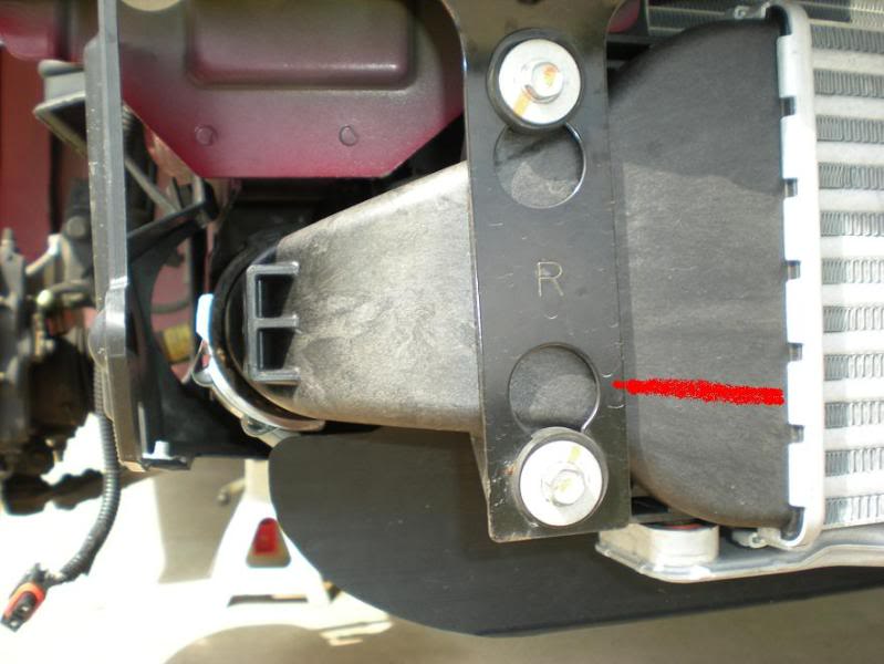

boost leak testing how-to in my sig
Also, OP, where you see the red line is about where two of my stock, plastic intercoolers cracked.
