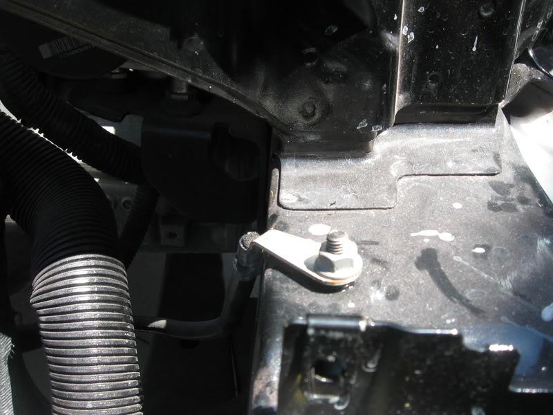

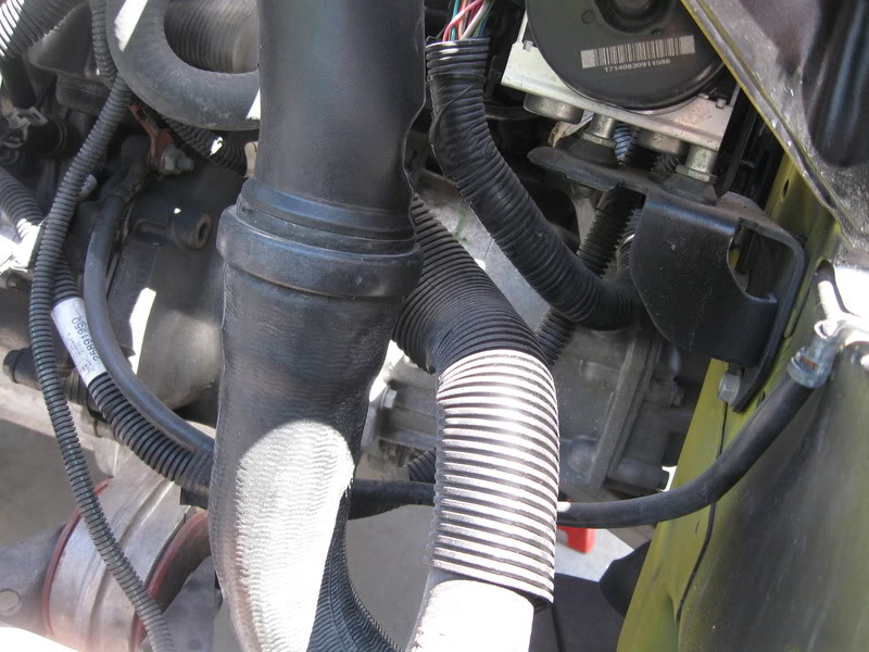

Old Jul 12, 2012 | 01:37 AM
SSlobalt's Avatar
Joined: 06-22-09
Posts: 5,989
From: Kathmandu

Originally Posted by SSlobalt
I have that one hooked up, but I am still not getting spark for some reason.
I am going to rent a code reader tomorrow and see if any codes are causing it.
