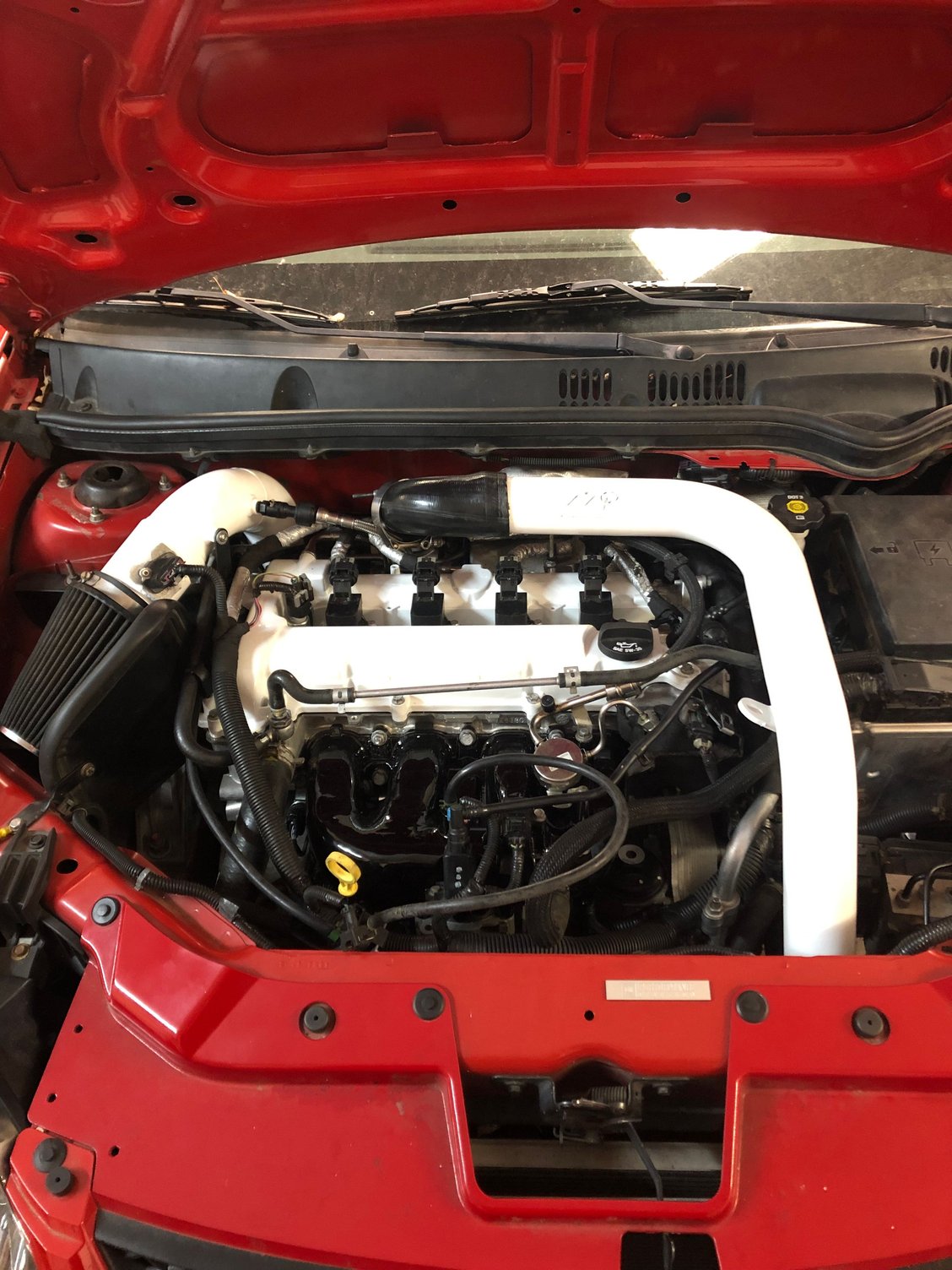

Pic of engine bay for fun.

I'm also assuming you put the clamp back on your upper charge pipe (missing the picture)

Thank you very much for the response. Yes the clamp was put back on! Haha.
