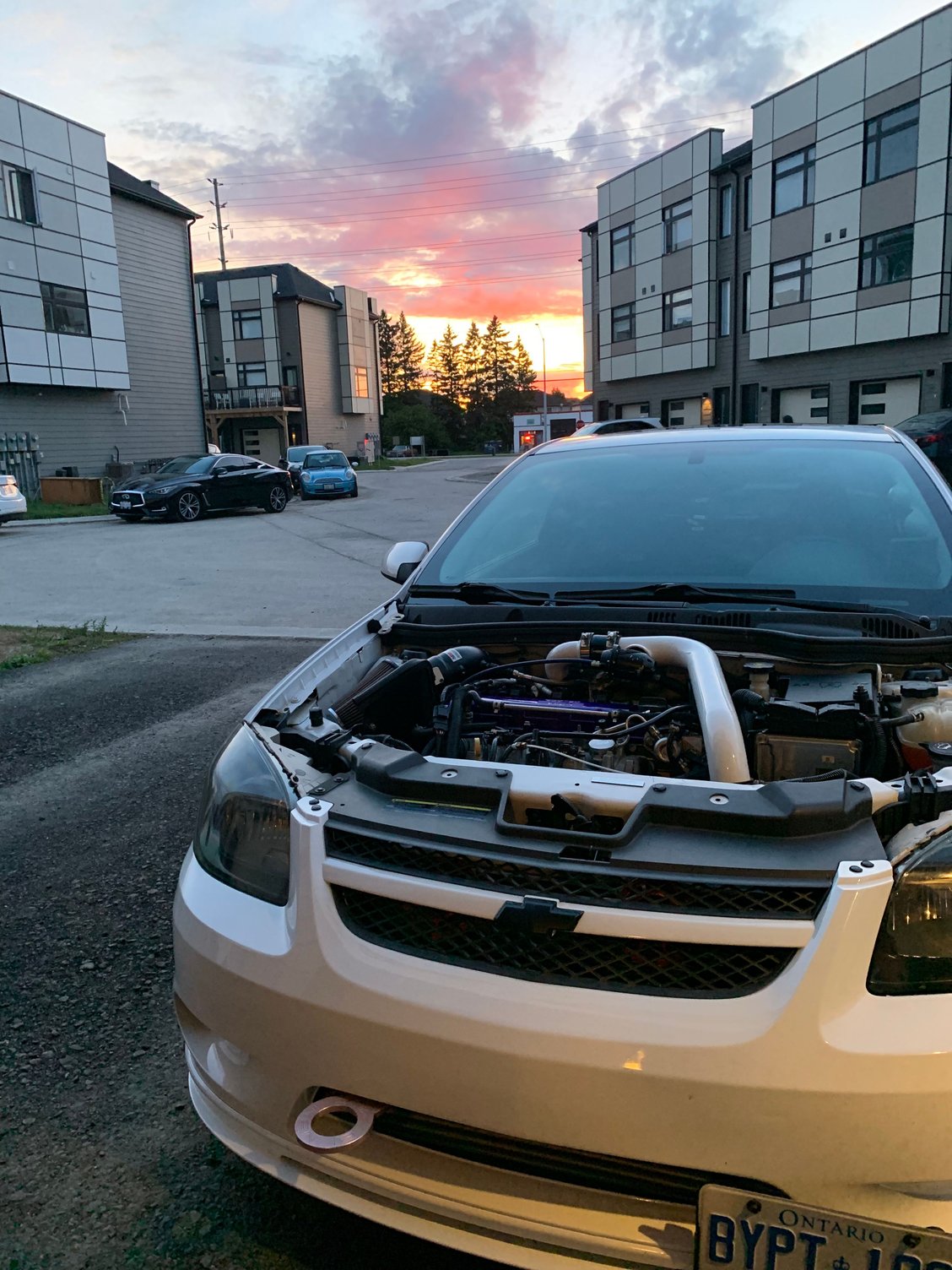

so I don’t know if anyone’s actually had this happen before but I have a 2010 cobalt ss turbo with a built LDK long block.
been chasing random misfires for some time now. Changed the coil packs, brand new plugs. Got compression/leak down test done & a smoke test the motor passed all those tests.
every time it rains the car starts to misfire I am not sure if it’s some sort of moisture either getting on the MAP/MAF sensors creating this random misfire seems to be only on CYL 1 goes up to 10-13 misfires idling some time. I do have a hole in the driver side fender line and the hole is right beside the SRI, could it be possible that water is going onto the Intake and going through the system getting water/moisture onto a sensor? I also do have a MAF relocate if that matters.
the other day I received a EVAP code, could this be causing theses random misfires? I have never got a CEL from the misfire I am logging them through my interceptor and can clearly hear them happening. Sometimes the car is not even driveable as when I get into boost the car jerks back and forth.
if any one has any idea what it could be please point me in the right direction thanks!
