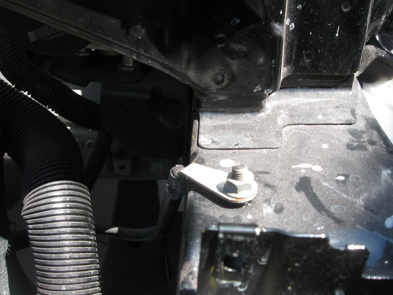

Sorry, 08. Forgot to mention my wife wasn't going to be home with my car until late.
Reading your latest post, I realize now that I don't think I did this how you wanted me to, but I disconnected my battery, disconnected both ECU plugs, and probed all sockets.
The passenger side socket had ground on the following sockets: 17 and 18.
The driver's side socket had ground on the following sockets: 1, 2, 4, 22, and 52.
As far as how you are reading voltage with the battery connected, you would have to tell me your method. I couldn't back-probe the ECU connectors because the wires head down into a 90 degree turn when entering the connectors. I'm a nice guy, but I'm not poking holes in my wires.
If there is another way you want me to do this, let me know and I'll try to get it done tomorrow.
