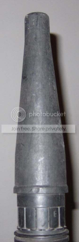

I got one of the first K&N intakes and it was bent as well. I just bent it back into a round shape using a hard plastic conical connector for a shop vac. Destroyed the shop vac connector but I didnt really need it. A hammer, something round that you can insert into the intake and some common sense should fix it.
Common sense is import so you dont hammer directly onto the intake and destroy it lol.
- saw off the tip.
x
And fixed
[img]
