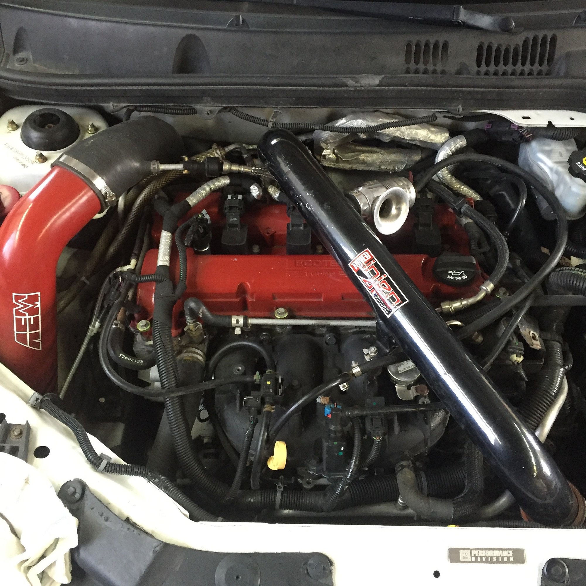

Bought this car from a dealer. A lot was done to it

That particular mark doesn't mean anything to me. Photos of the rest of the car? Looks white.

OEM MAP sensors
AEM CAI
Injen with Atmo BOV but looks to still have the stock BPV hooked up
I'm leaning towards a custom tune if you're not seeing check engine lights and/or black smoke out the tailpipe along with driveability issues.

I have check engine light, for evap. I believe p0451 or p0452. No carbon coming out, drives amazing none the less. Whoever did have it did something, it also came with a b&m short throw and a high flow cat.

First of all. What does it boost to?
Does it change with traction control on or off?

Around 20 to 21 psi. Doesn't change with traction/launch control. And thank you for the welcome glad to join.

So the car is hptuned or has a gms1 tune but I doubt it's the gms1 tune with a bov
Old Jun 5, 2016 | 11:18 AM
blueLNFftw's Avatar
Posts: 10,359
Likes: 84
They use the cruise control button not traction.
It still could be gms1 with a bov. People do **** wrong in these cars all the time and insist it's fine.

Unlikely that it's GMS1, it's not running the GMS1 sensors. Gotta be an HPTuner tune. Might be running a MAF relocate as I don't see the MAF wire up top.
Old Jun 5, 2016 | 10:08 PM
I forgot about the gms1 sensors, yeah has to be custom tune for sure
