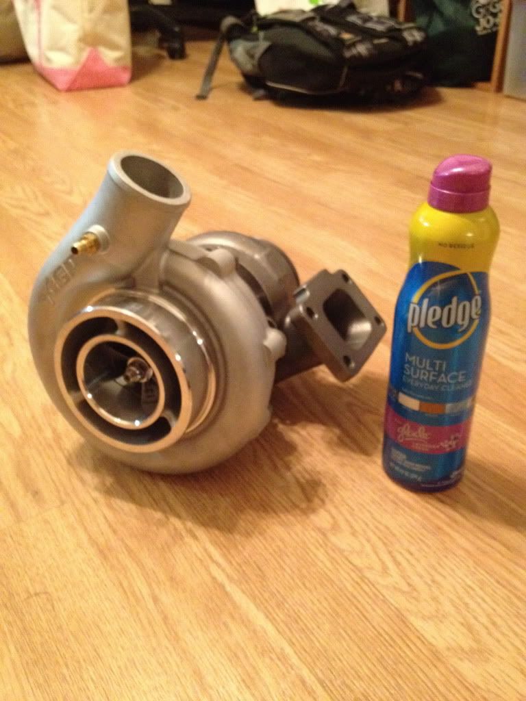

well for a while now i have been saving for a build and since the oil pump incident have gathered enough coin to get some stuff together Have more parts other than in the picture but the building phase is about to finally begin!

Looks like a bunch of win to me :-) what turbo is that?

Gotta be the S256, if it's a play-to-win build.

sslobalt you are correct! mods are:
Borg Warner s256 turbo with .63ar
wiseco forged pistons
k1 forged connecting rods
stage 1 ported and polished head from zzp
zzp stage 1 cams with enlarged fuel lobe
zzp 82lb valve springs
precision 46mm waste gate
big turbo intake
ottp charged piping
mpx front mount intercooler
mpx resonatorless cat-back prototype
zzp catless dp
Aem water methanol system
ati underdrive balancer
zzp neutral balance shafts
zzp 5th injector for e85 kit
aeromotive in tank fuel pump
arp head studs
tune

Doesn't look like my s256et I got in the mail a week ago. But mine is the .55 A/R
Old Feb 27, 2012 | 01:14 AM
cmiller8006's Avatar
Joined: 05-29-08
Posts: 6,079
Looks like a 256 to me.
ryansalazan's Avatar
Joined: 08-15-07
Posts: 1,668
From: texas
ya i got a s256et but its from a diff company. should be just about the same thing tho

s256et.jpg picture by raver0789 - Photobucket
this is what came from zzp.

maybe just the bigger AR?

well the ar is the exhaust wheel. so the only difference is that my exhaust wheel would be bigger. other than that maybe its just the design?
Your S256ext is how we order them. You can run the small cover or the big cover. The small cover fits behind the engine much nicer and help maintain compatibility with our other kits.
The OP's pic doesn't look like a s256ext but it's kind of hard to tell from the picture.

yes its a s256et but its not from zzp so maybe thats why the design is a little different?
It looks similar to those Garrett twin-scroll type housing. Looks real serious.
And thanks joe! haha finally should have it running in about a week
AR isn't the size of the wheel.. It's the ratio of the area of the inlet to the radius of the exducer to the outer wall of the housing. Basically the size of the turbine housing.
