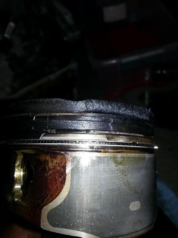

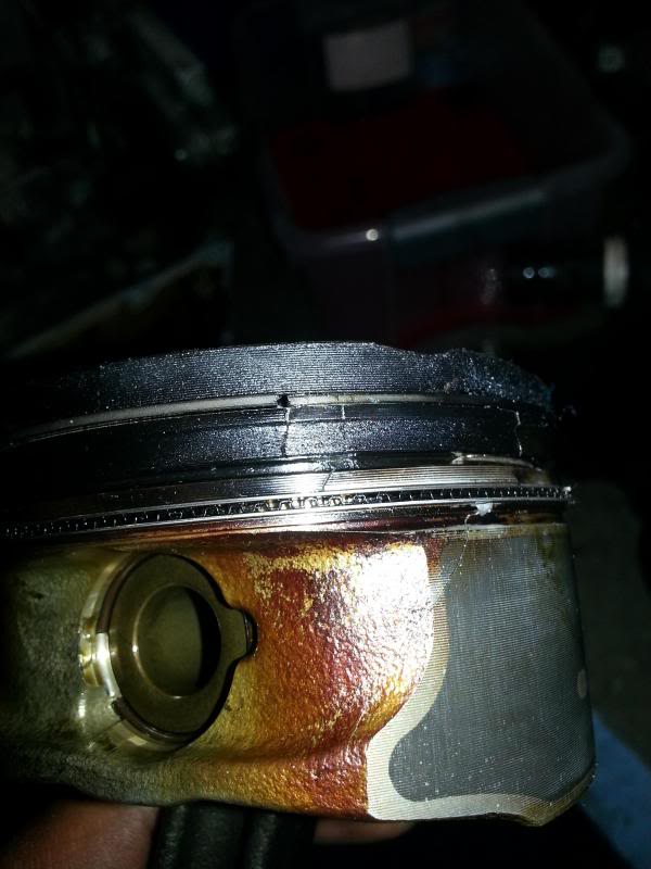

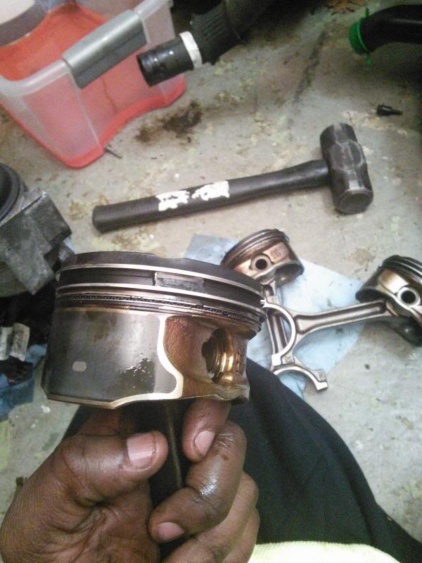

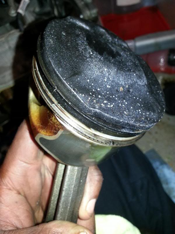

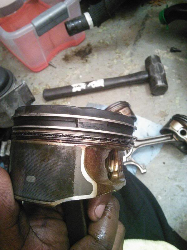

Alright gents thanks for the free bumps back on topic i finally got her open...Block is fine... Presenting Pistons 1 AND 4
and 4

Hey. That's not right.

Yea its not Lol

Damn, dude. actually pretty lucky. How do the cylinder walls look?

detonation is a bitch

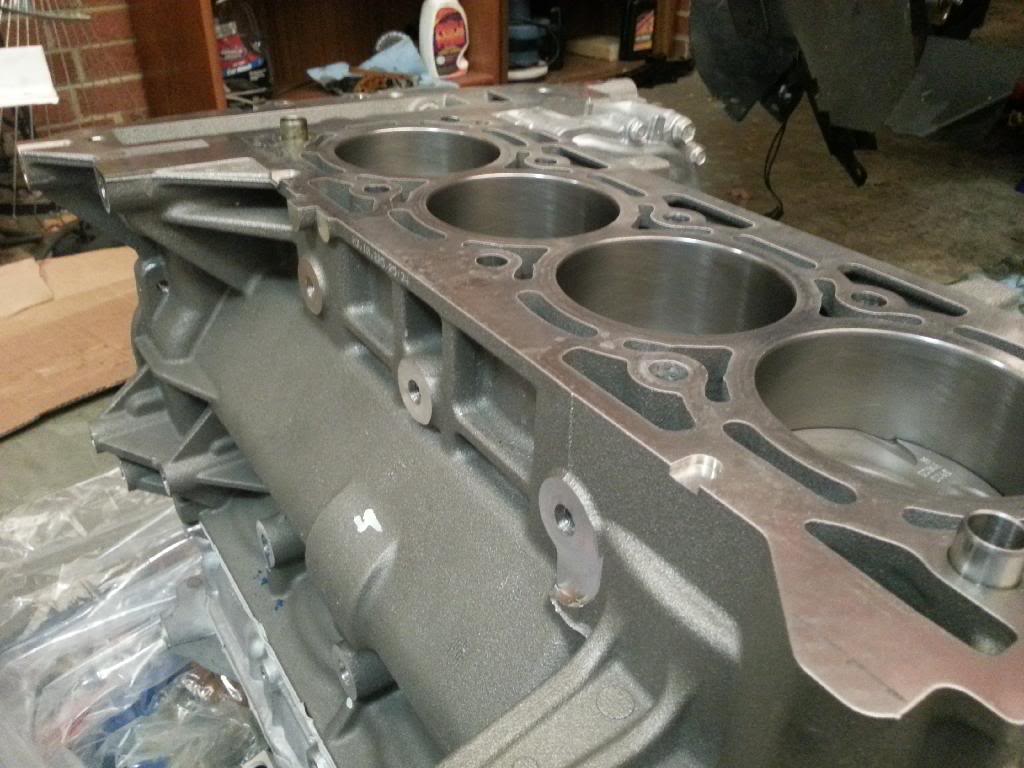

The Cylinder walls look pristine still I dont know how.

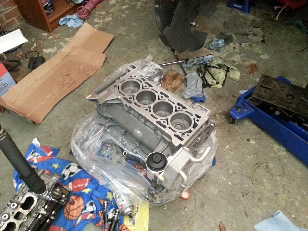

What block is that?
Old Jan 31, 2014 | 12:28 PM
  #84
Gen2 lnf
get it checked for taper and roundness

Damn. Look at all that coking. Yay, DI!

thatll do it... lol

Alright So everything is officially Here today! Pics and Build pics coming soon... We can Rebuild Her!
I also started my first Retro Build because she was down for so long!
